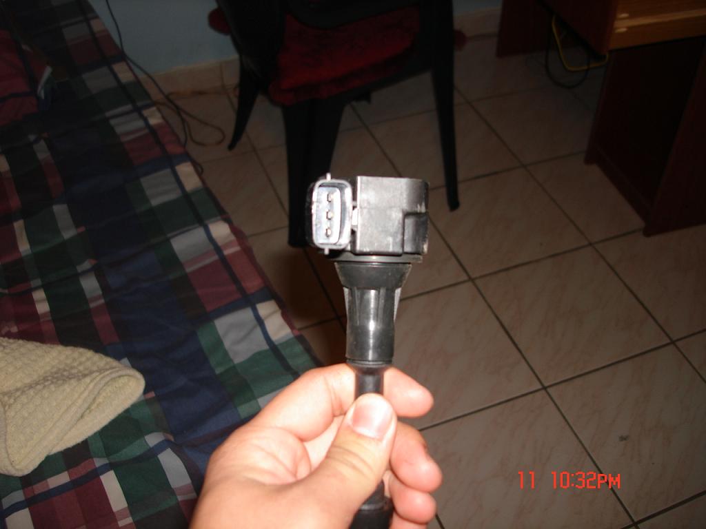

anyone know what each pin connects 2 like B+ ground ect. thanks ive searched for wiring diagrams but nothing
