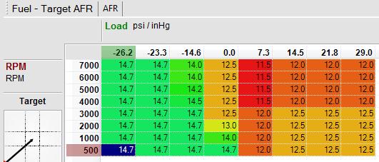

Forgot to mention that I'm running the Haltech as the ECU. I have attached a shot of my target AF's. From what i can see during driving the AF's do match the table etc. I personally thought my car was running rich so I compared my haltech WB to another manufactures one during driving and they are pretty close even though the haltech is pre cat and the other one was at the exhaust tip.
My driving style is not IMO considered hard or aggressive. Give it a squirt now and then and used as a daily driver to work.
Boost = 7psi

Maybe my closed loop is where my issue lies. I have logged my WOT previously and it is was a solid 11.5 AF from memory.
Didn't mention this before but my WB which i use for closed loop is pre cat but this is located near the shift leaver. This may not be the best or ideal position as it is too far downstream. Haltech modded my map background calculation so that the WB would react quicker to compensate for the distance but maybe this is not perfect. Might get a O2 simulator for the factort O2's which sit about 6-8" from the turbo and move the WB up to one of these bungs.
