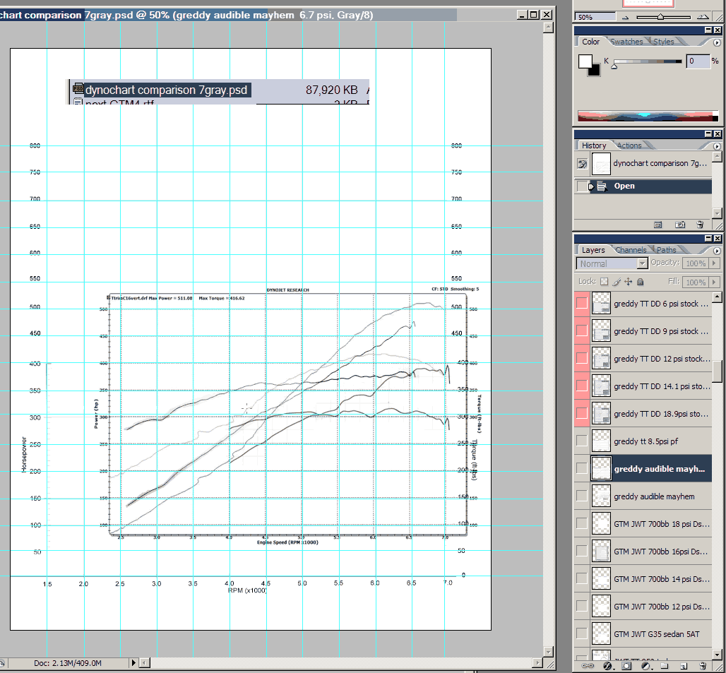

yeah I did have dynos from my car when I changed out my exhaust from a nismo to a modified APS with X-pipe along with some other things. I'm just not going to go to the trouble to find them just for you when I've already posted them before etc. They're not exactly perfectly scientific though since they were done in different weather, and there were some other minor parts changed as well
My opinion on the matter is based on the data I've seen over the years. I used to save everyone's dyno and basic car info to these HUGE photoshop files where I normalized all the charts. Together I have over 400 dyno charts saved out in this file.
You easily start seeing patterns after awhile when you start collecting a lot of dynos. The results aren't always going to be repeatable on another car. Some guy could change his exhaust out, but what else does he have on his car? If you get the same exhaust, you probably won't get the same result unless you match the rest of the parts. So the best you can do is look for patterns over a huge collection of data because one, two, three, or ten dynos isn't going to really be enough to paint an accurate averaged picture
Most of the data you're going to find is where someone posts their dyno from awhile ago from a different season of the year and the new one after they changed a few things (not just exhaust) and retuned. FI People just don't bother to spend the money dynoing and retuning over just an exhaust change unless they're turboed where an exhaust can make a massive difference. Most SC people usually end up doing a combo of things like pulley, injectors, exhaust, headers all in one go so their money is being efficiently spent on a new tune.
Anyway, take it or leave it. I'm just trying to save you the trouble of looking things up yourself. I've seen enough dyno results from others including myself to know what generally is probably going to happen with different exhaust setups. Jeremy has also said what he's generally seen happen at his shop on his dyno over the years.
The total flow is what's important. You could have cams, headers, stock cats, and exhaust that overall flows the same as a car with stock cams, stock headers, test pipes, and exhaust. The dyno curves can still end up being fairly similar even though totally different parts have been modified.

Originally Posted by jpc350z
I say show me and you say I won't..I have dyno's but I won't show you.
It's not just me it's the many many posters that have asked and will continue to ask...
Nice guy you are..
Ok, then how would you like me to send you a 90 meg grayscale photoshop file?
I have 6 other smaller ones as well. Not just Z dynocharts, but other cars as well with various mods.
Where do I send them?
Do you have an FTP I can send them to or some web space somewhere?
Do you use AIM?
How about I break them into a bunch of 5 meg zip files and email them to you, or will that be likely to suspend your email account?
Do you even have photoshop in the first place?
or do you really expect me to post over 400 dyno charts...?
They really should just stay as .psd files because the layers are just isolated curves by themselve with the blank graph showing through on the bottom layer
....I thought it'd be easier if I just shared my conclusions from staring at and comparing all these charts over the years
Attached Thumbnails Is A Larger Exhaust Better For Vortech/Procharger Kits-dynocharts.gif
