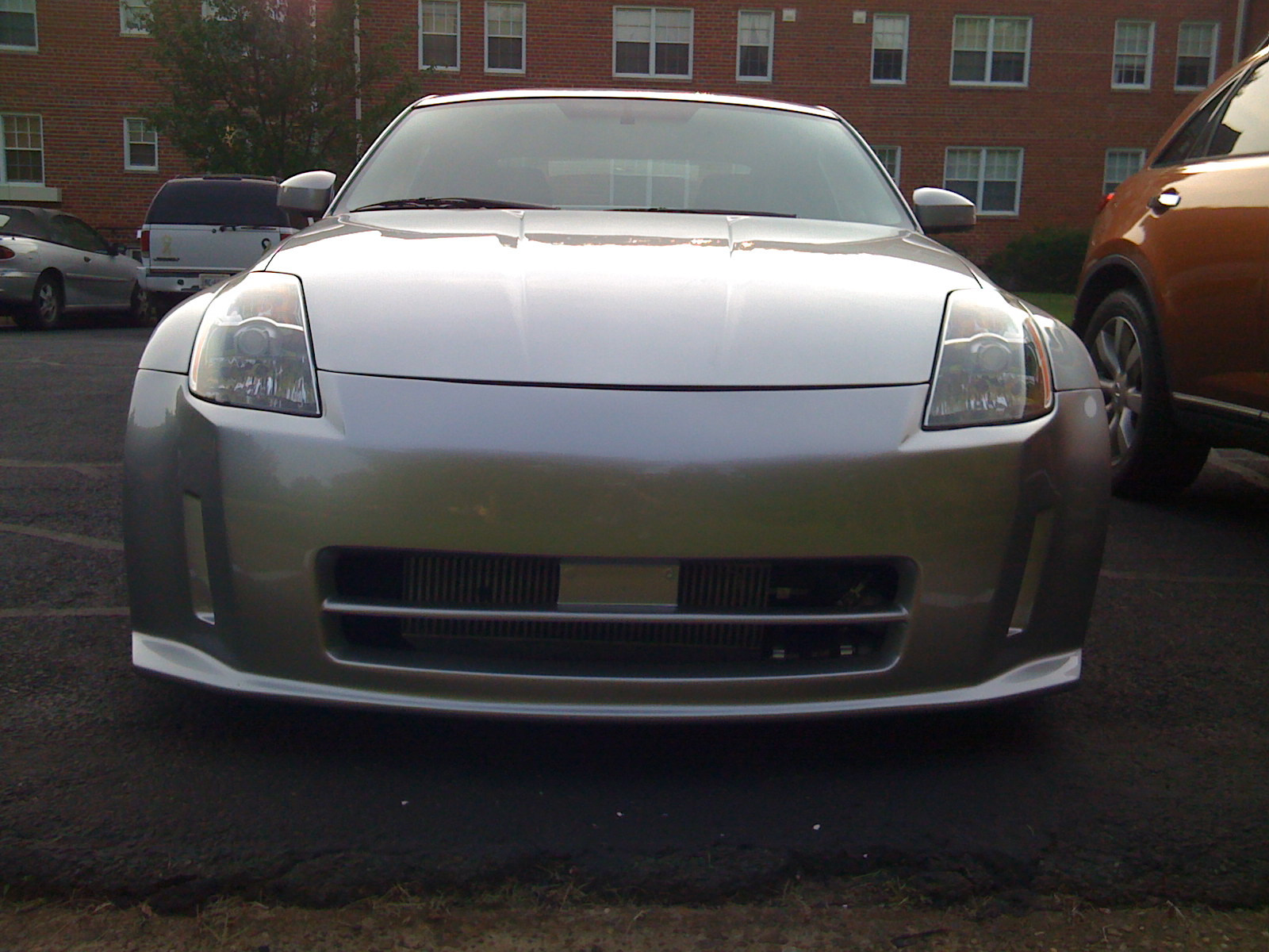

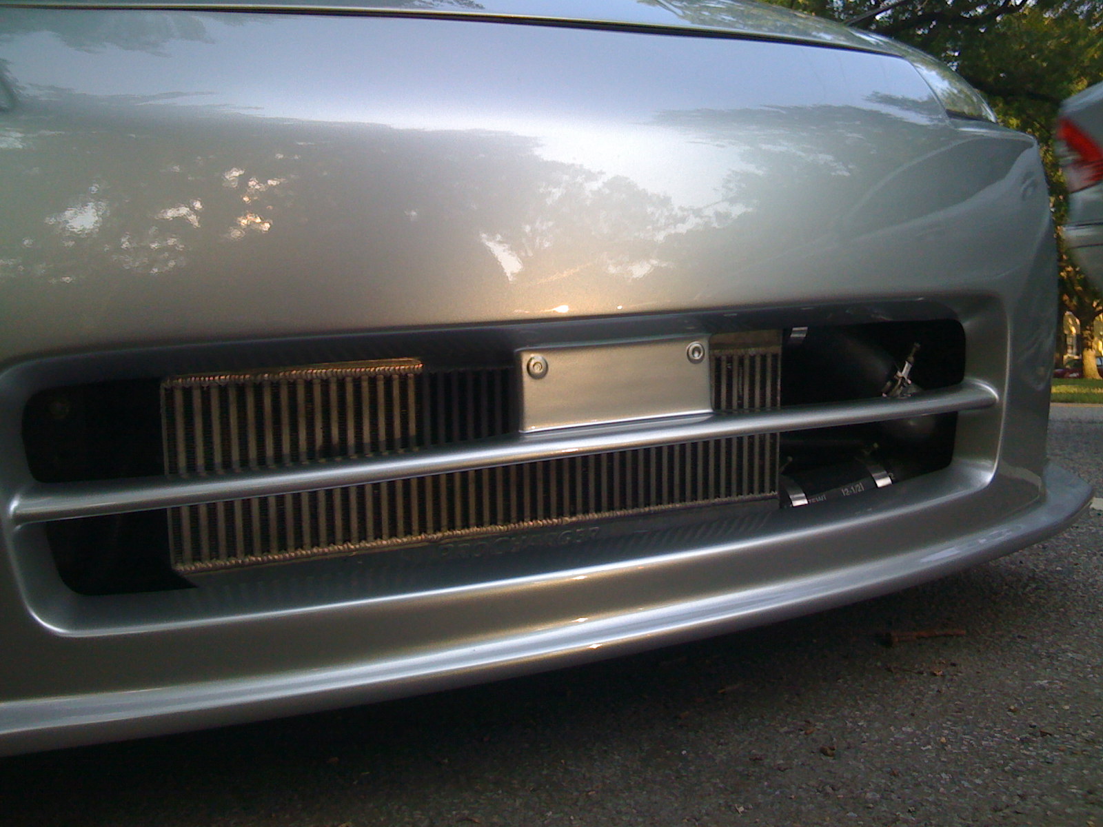

Here are some pics of the new front end and paint.
Attached Thumbnails Low Boost on ATI-img_0312.jpg   Low Boost on ATI-img_0308.jpg
