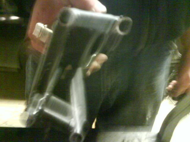

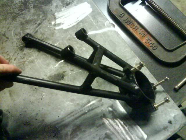

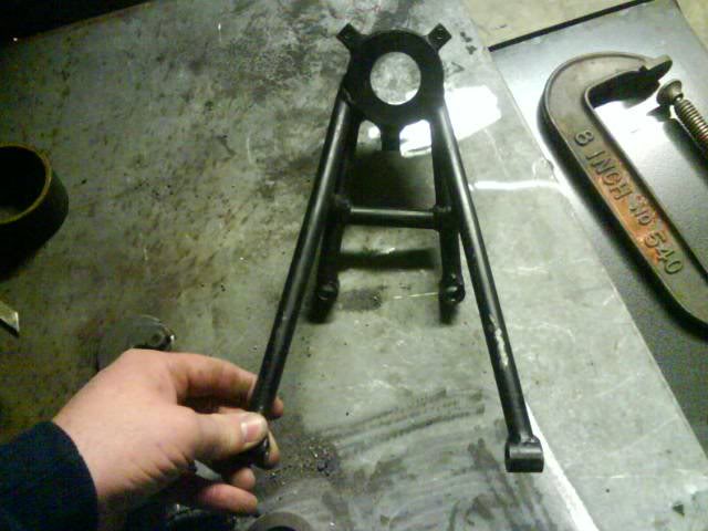

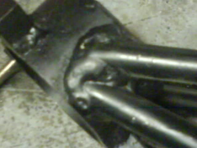

Well I wasnt happy with the quality of my original vq mount kit that was made by that other company so I decided to make my own...
Pictures of the janky shifter bracket I originally had:
Dont know how much you can tell but its all bent up and welded funky, its in no way symmetrical.
Crappy welds:
Cut it up to see what I expected, hollow round stock:

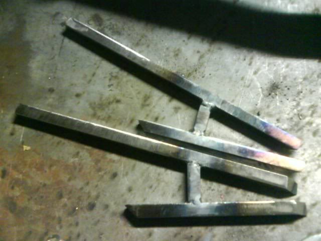

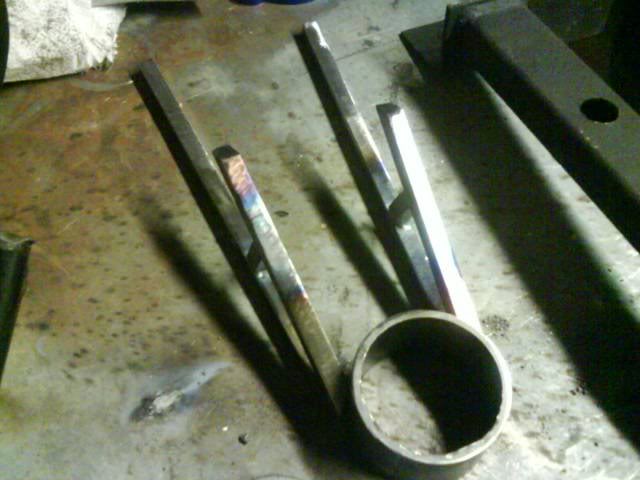

Overall this shifter bracket is just plain shotty, there is even play where the round part of the shifter sits in. So here is the start of mine:
Solid square stock:
Bracket ready to be welded together, just need my buddies 350z trans to make it easier for fitment this way we can tack the bracket together inside and outside the car without me having to remove my trans:

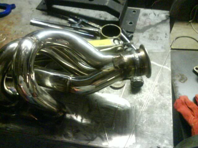

My stainless steel fittings and piping came in today, a little teaser, we cut the stock flange off our headers and did this to it:
Im In Da Club Hollerin' v-band band, v-band band....lol
