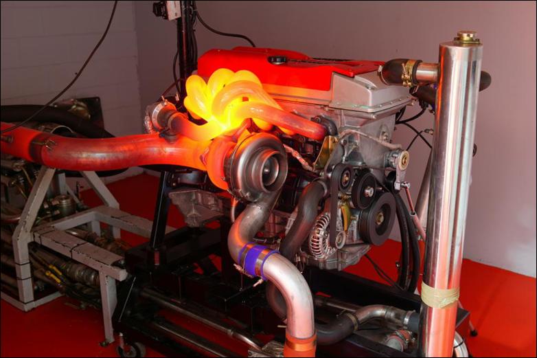

Remote turbo-2311_12mg.jpglook at the picture.... do I want that next to my transmission and clutch lines? I wonder what a red hot turbo could mess up? Thats all im saying...... Heat is an issue... now if you have ways to combat the heat then great..... and im sure if you have more money then time you could combat the heat problem.... its all a matter of choice.... remote mount= a little turbo lag..... cooler IAT... more safe....... Engine mounted= less lag... way more money to do the right way to be safe.....

Attachment 203463look at the picture.... do I want that next to my transmission and clutch lines? I wonder what a red hot turbo could mess up? Thats all im saying...... Heat is an issue... now if you have ways to combat the heat then great..... and im sure if you have more money then time you could combat the heat problem.... its all a matter of choice.... remote mount= a little turbo lag..... cooler IAT... more safe....... Engine mounted= less lag... way more money to do the right way to be safe.....
IATs are a moot point in this discussion. That is just a matter of buying a good, high quality bar/plate intercooler.
That engine pictured is suffering from some SERIOUSLY BAD EGTs. That my friend, is a tuning issue. With tuning that shitty, the engine will fail before anything gets a chance to light on fire. Heat is much less of an issue than anyone here is making it out to be. If you are not going to spend the money to have a reputable tuner give the car a proper tune, then you deserve a fire under the hood.

^ headers get close to that hot by them selves man...hell fire shoots out of them!

yeah, by themselves, when the engine is running a shitty tune. The only time that should happen on a healthy car is when the person has been running at high rpm's for hours at a time.
