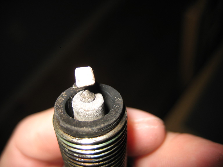

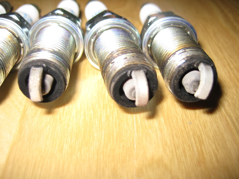

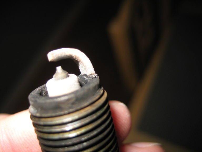

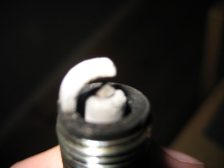

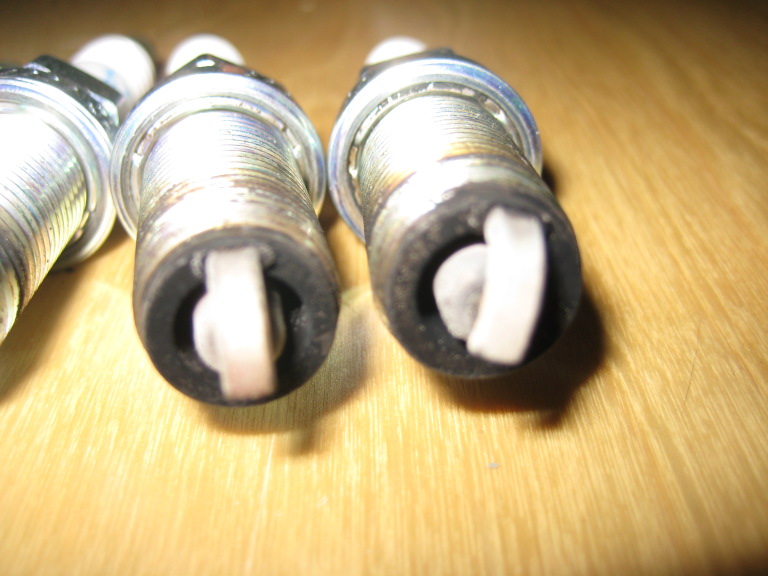

update- took it to AAM since I was in the area, they pulled the plugs and plug 5's had a larger gap, a 4 or 5, ended up switch the plugs to copper and ideal was smooth.
Thanks clint@AAM

my plugs look lean. i havnt used octaine booster and my afr are reading in the 10's(11's on the dyno afr). so im kinda at a loss, possibly engine breaking had to do with it since my breaks were shot i was engine breaking for a bit
