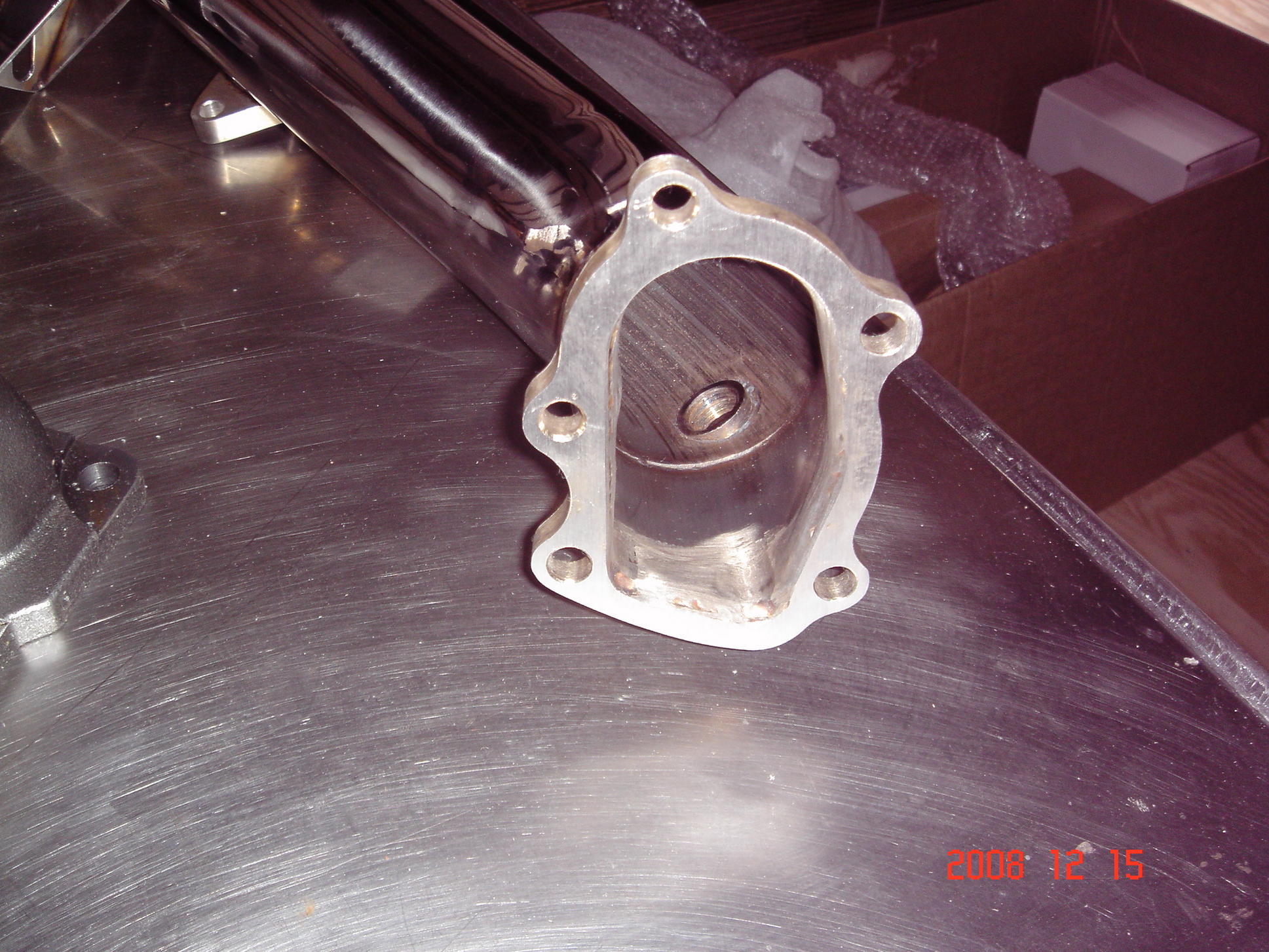

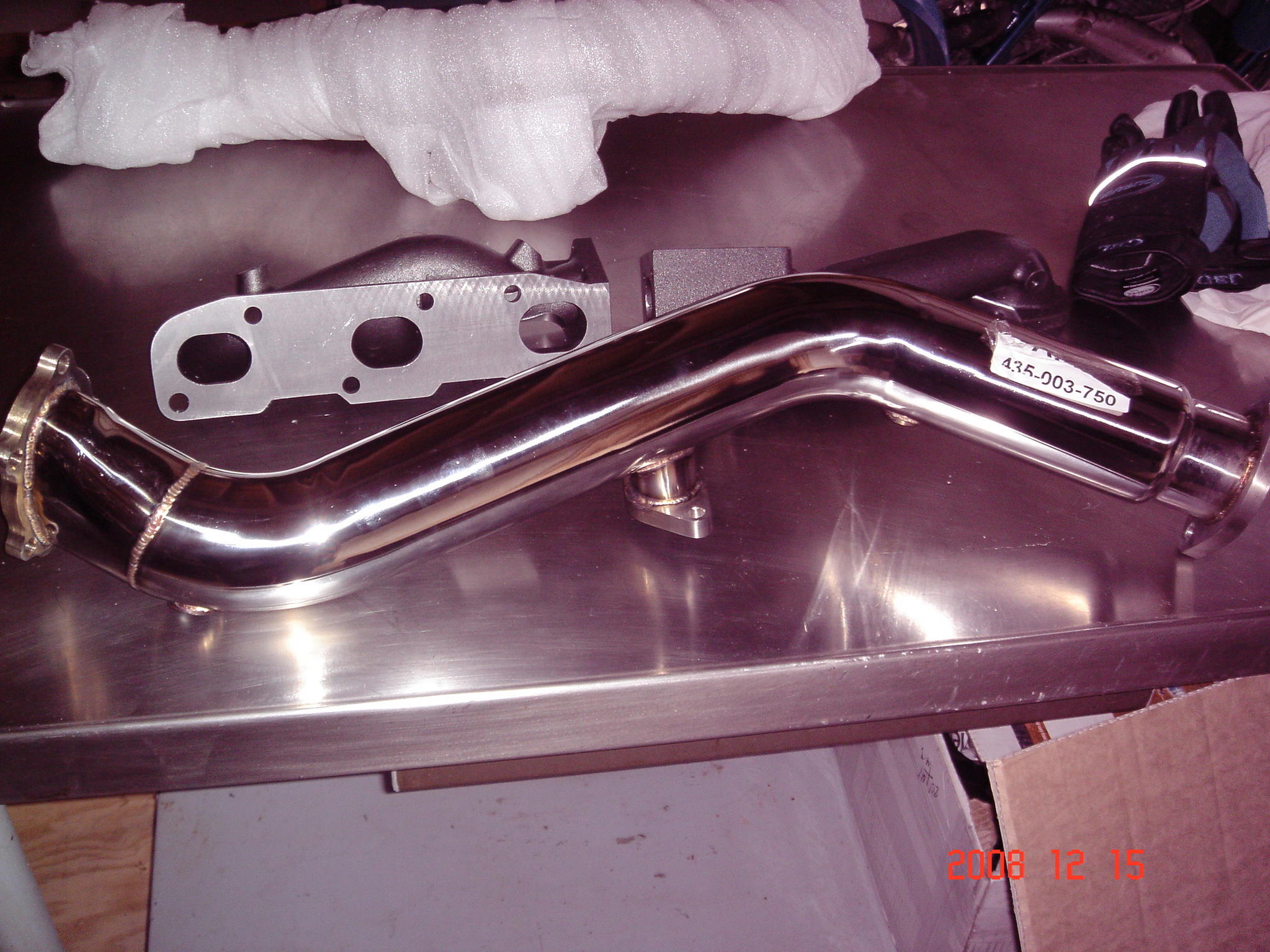

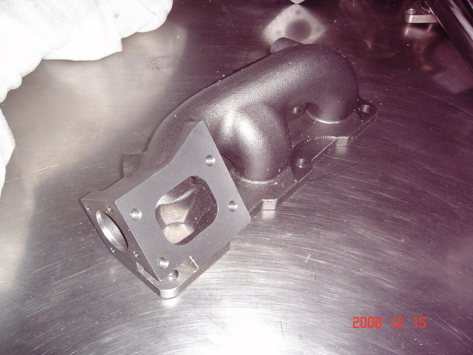

An added plus of the new APS tuner kit is that it basically comes with the manifolds, downpipes and wastegate pipes from the extreme kit. Compare these to the website:
BB turbo's VS. jurnal bearing turbo's-dsc03996.jpg BB turbo's VS. jurnal bearing turbo's-dsc03995.jpg BB turbo's VS. jurnal bearing turbo's-dsc03997.jpg
