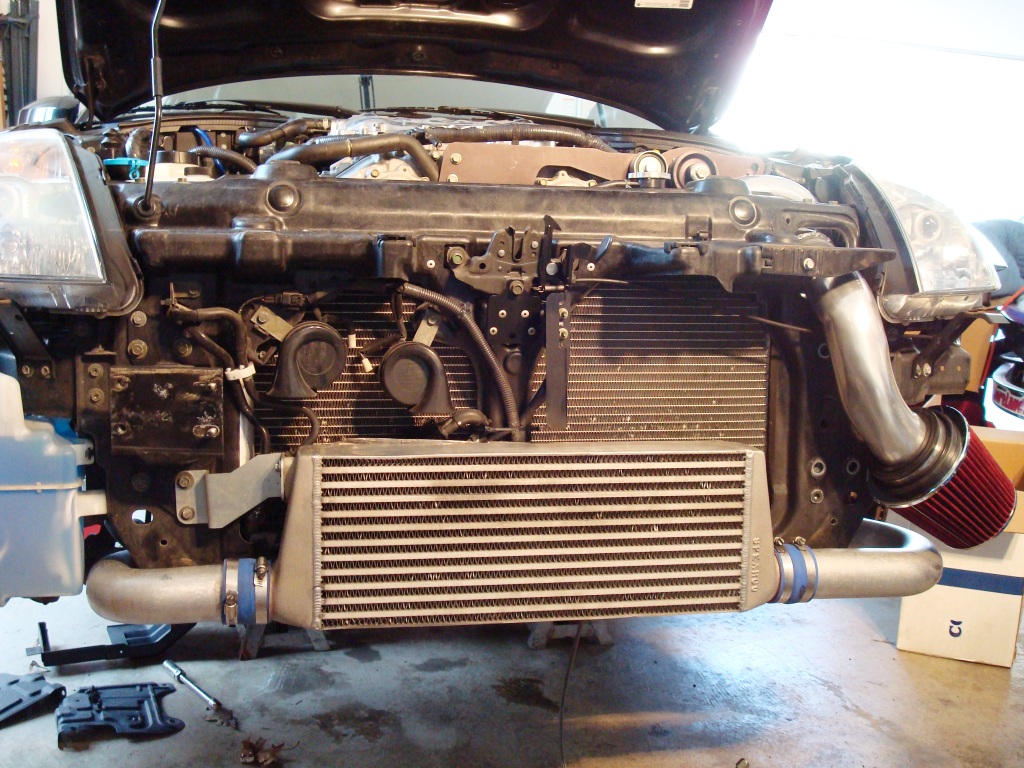

Here you go.

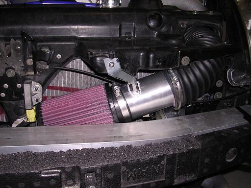

Default Here is mine.
CAI
Attached Thumbnails Recharging the Vortech Filter-intercooler-and-intake.jpg

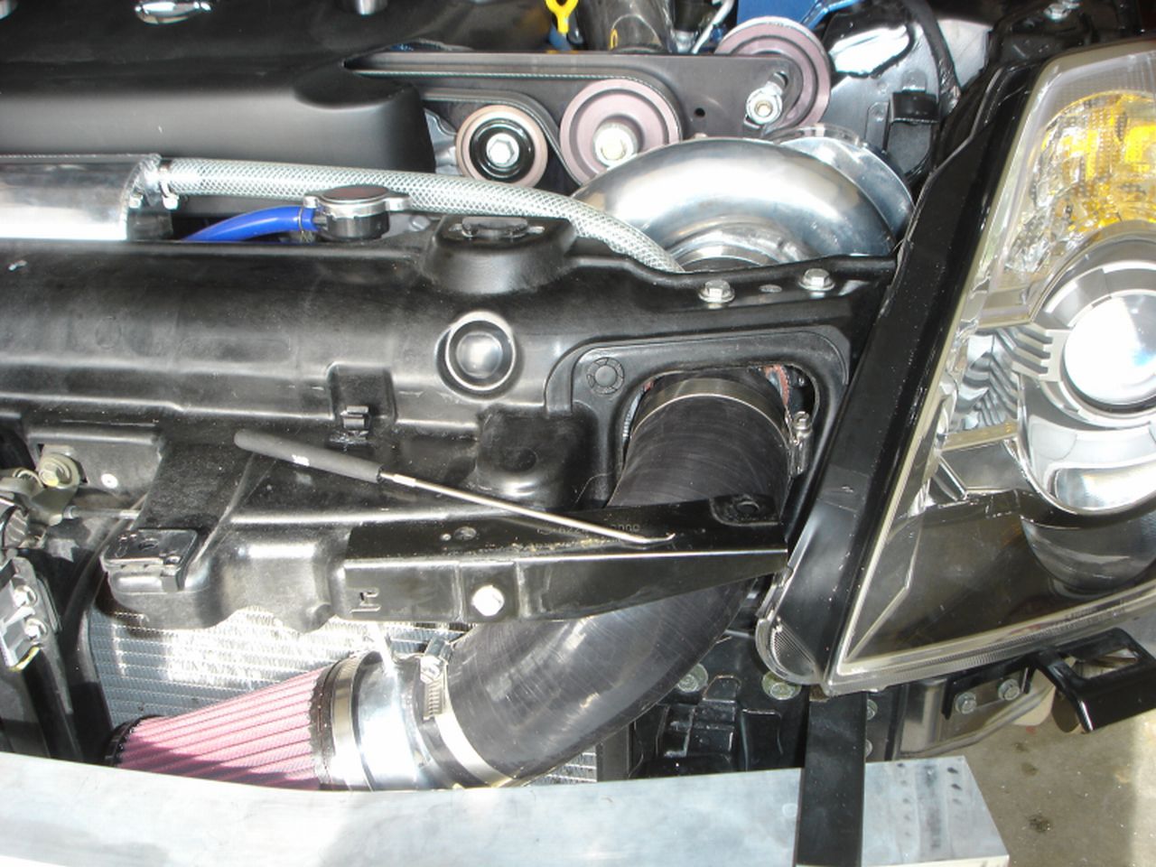

Here's what we went with...

Thanks for the pics to show your filter setups. It appears as if you're at least taking off your front bumper to recharge the filter, except for maybe 350Z400whp who might get access thru the fender well.
Those filters should allow for ingestion of larger air volume but how does the larger surface area of your filters impact the engine performance compared to the smaller area of the Vortech filter?
  • Any danger of overloading the MAF?
  • How about any extra rwhp gained over the Vortech filter (e.g. larger air volume allows for more fuel to maintain A/F)?
  • Don't suppose you have any Vortech filter vs. modified filter dynos?

The only thing I can say is a couple of times if I accelerate to 120+ (which is very rare) and say put it in neutral and coast that I have had my engine die after 5 or 6 seconds. I have heard that the JWT intake even on a non FI car has tendencies to stall under these conditions. Maybe my air filter is in an area where pressure is created and this happens. Not a big deal, I just leave it in 6th if I am ever slowing down from high speeds and it rarely happens anyway. Having an easy to change filter would be cool but I just love the way mine looks. I think having the filter right on the blower has an unfinished look and the stock vortech filter just looks ghetto, sorry guys but its not your fault, Vortech should of spent just a little more and added a CAI like every other FI kit does. so I'll live with it being harder to change. I am thinking about selling mine though and going with a setup more like the Powerlab / Turbonetics style over the inter cooler. I think this might look pretty cool too and provide even more airflow.

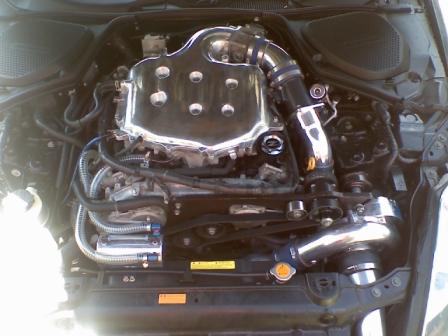

Top View. Oh and by the way that's a Cusco catch can so yes even Vortech guys can mount a can there. I think the Greddy would fit too. I know that many have complained at how hard it is to mount a catch cat once you install a Vortech. I never thought I had the room there but to my surprise the hood shut and doesn't touch.
