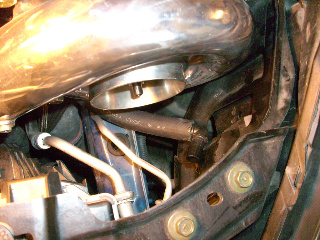

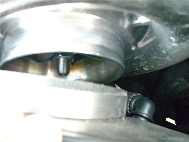

Does anyone have a filter recharging secret they're willing to share?
I searched a couple different ways but could'nt find exactly what I'm looking for. It is time for me to do the first recharge of my filter but the thing is really wedged in there!!!! Managed to get it unclamped from the charger but can't even reach behind it to disconnect the tube (crankcase ventilation?).
From looking at the setup, I figure a couple different ways to recharge it but all involve varying levels of disassembly
Any constructive suggestions would be greatly appreciated!!
Also found some oil residue on the filter side of the impeller. Contacted Vortech but have not yet heard back from them....any ideas / solutions?

You really just have to squish it and pull it out, then do the opposite to put it back in.

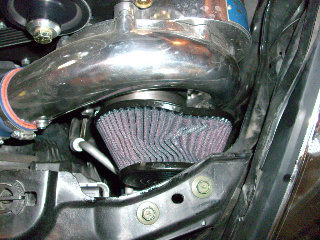

After jacking the Z up to investigate the fender method, I decided to go with the squish method.
Now my filter looks like ***
There were a few serious obstructions to the fender method..... a fender / headlight support on the side of the filter that bolts to the radiator as well as a frame rail and two metal lines (AC?) below the filter. Couldn't see a way to get the filter out without tearing it all apart.
Thanks for the tips though; I managed to refresh the oil/filter and air cleaner which makes for a happy Z.

I hated that little filter. I trimmed out the plastic in front of it and used the K&N rx4140. Its more than twice the size. I used to clean my Vortech filters every 3 weeks. Gotta let that blower breathe. It was definately a difference I could feel. I still have one in the box if someone wants it. The one on the right was a used one to show what it looked like.
