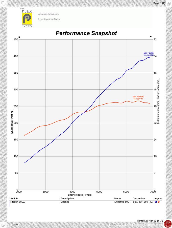

Woah, what a bumpy trip this has been, but it's finally over!
After a bunch of installation problems, and once we figured these out, yet another new issue, that wouldn't allow me to run proper boost, we're finally done.
I had the car tuned yesterday. When I got there, and after going through all this, I was thinking I'd be happy with anything over 350whp. One hour later, I had the dyno sheet in my hands and I couldn't believe it!
The car drives amazingly. It feels exactly as described on this forum, like having a much higher displacement engine. The only thing that reminds you that it's FI'd is the surge of power you get above 5,000 RPM and the chilling WOOOSH you get from the BPV when you shift.
The driveability is like stock, I'm not kidding. Well, maybe even better so. On the way home yesterday, I was riding a hill in a country road. I was on 4th, even 5th sometimes, and didn't even need to shift down.
The sound, even at half throttle, is awesome. I drove a million miles yesterday, because I just couldn't get out of the car.
A huge thanks goes out to you guys, for trying to help me with the setup problems. I'd have lost all hope if it wasn't for all the talks of advice I got the last few weeks.
Also, many thanks to Jamie at Vortech, for the great communication and his willing to help me out any way he could.

Damn, peak torque at 6k+ RPM? That thing just continues to pull harder and harder all the way to redline. Nice!
PS does your boost creep up as the rpm's increase? Just curious.

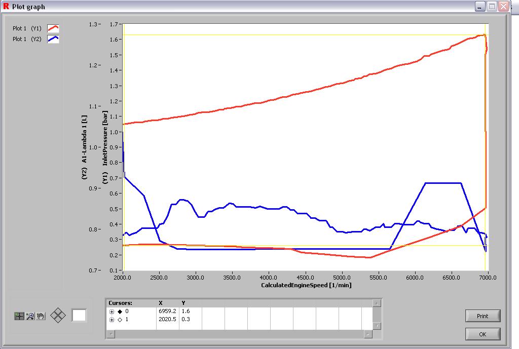

Yea, it seems like it doesn't let off until the rev limiter, by the looks of the graph.
Vortechs build boost relative to your RPMs, so it keeps building steadily and linearly as the revs go up. See attached graph, red inclining line is boost/RPM
