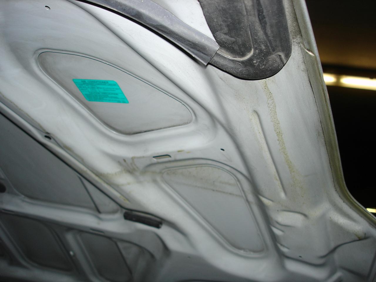

I've had some sort of leak from my Vortech for quite some time now...it leaves a fine layer of oil around the blower and on the inside of the hood of the car, but it only happen when I drive extremely hard (usually on track days, or when go on a full WOT run)...
I'm pretty sure it's from the Vortech...what I'm unsure about is whether it's coming from the oil return line or from the blower itself...
Anyone ever have these symptoms with their vortech?

I have seen them leak on the seal around the cogbelt pulley on the closest one to the headlight.

That sounds about right. And check inside your intake tubing to make sure it's not leaking in there as well. Mine leaked oil spray into the intake for years.

it must be something leaking onto the belt, i would say your seals are going bad.

**sigh** yeah it looks like that too...time to shop for a T-trim

When my blower seal went it sprayed copious amounts of oil where your's is hitting the hood as well as up and thru the hood opening onto the top of the left fender.. A major seal leak during very spirited driving..
