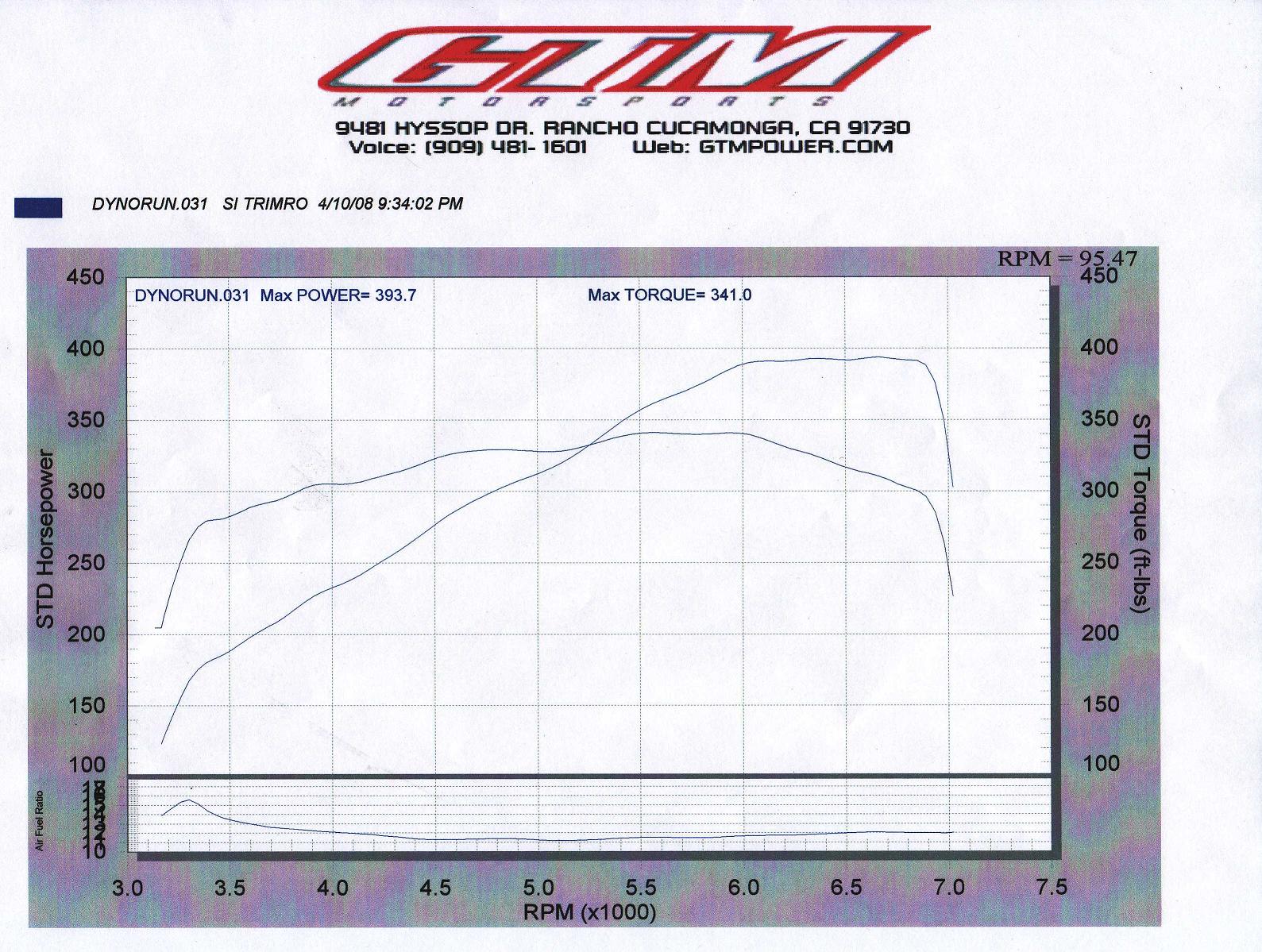

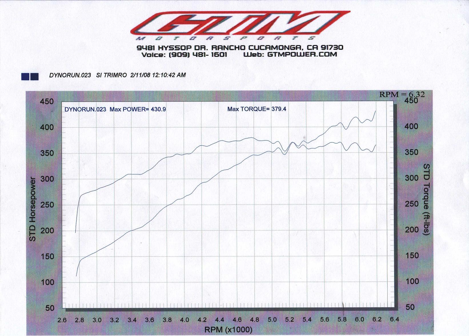

the graph on the left is the 32/28/2.87 pulley setup. the graph on the right is with the 34/28/3.12 pulley.
BTW the graph on the left was not my final pull and tune. there were some belt slip issues due to a brand new belt being installed at that time. we complied with a couple of more pulls, re-tightened the belt and performed the final tune. unfortunatly i do not have that final dyno graph on my work computer. the final pull was the same hp output but i gained 10 more foot pounds of torque. sorry
Hard to read the a/f ratio on run 23 but it looks like it was lean on fuel..Was there any fuel trim's made to run 31? It does not register to me that going with a 2 tooth larger J/S would or should make any measurable difference in power particularly a loss..
