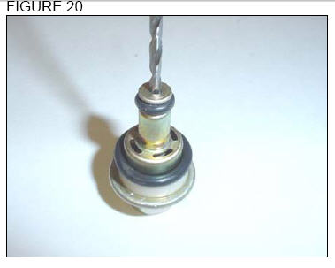

Sounds like you hurt the regulator and it is not holding pressure. What do you mean you drilled out the regulator?

http://turboneticsownersclub.com/tur...icsinstman.pdf
H: Remove the factory fuel pressure regulator by removing the plastic retainer clip pointed out in FIGURE
19, and prying the regulator out with a small flathead screwdriver.
I. Carefully hold the regulator in a bench vice (or similar) and drill out the bottom orifice using a 7/64” drill
bit, only until the drill breaks through the first thickness of sheetmetal (about 1/16” deep) SEE FIGURE 20. This step is necessary because the orifice size restricts the flow capacity of the upgraded fuel pump.
