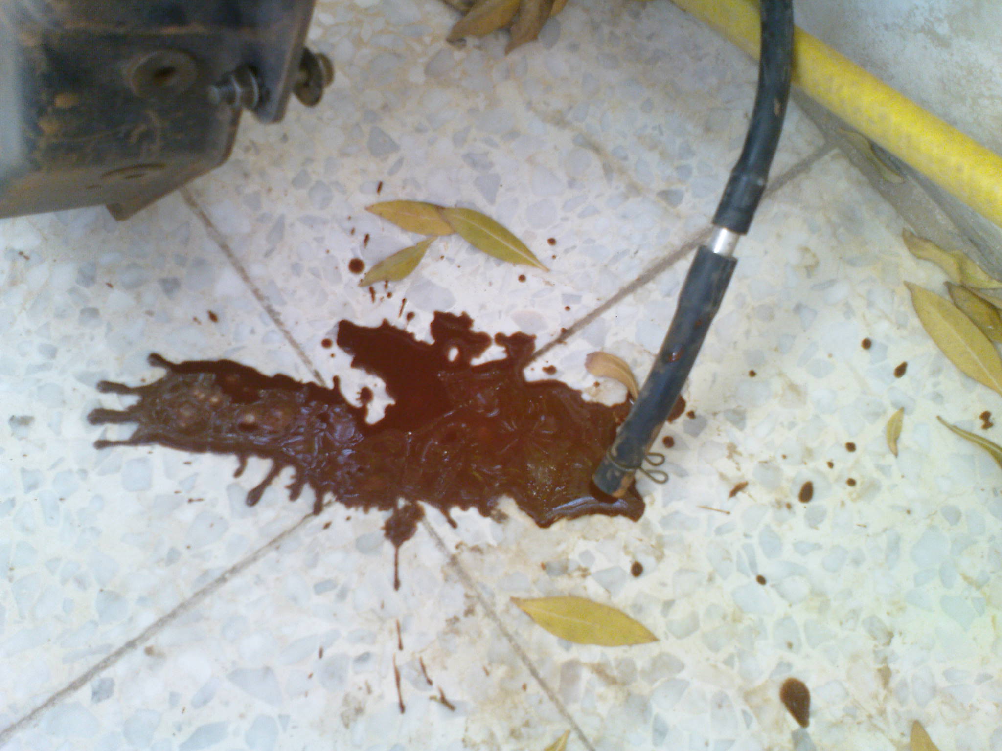

Originally Posted by nomyth46
i find it very odd that every cylinder drop the same amount of psi, that means that if the rods bent then everyone of them had the same degree of bend or if a intake/exhaust valve was leaking then it would have to have the same amount of leakage on every cylinder...........i think thats highly unlikely and almost close to impossible...........as far as overheating......are you getting any air in your coolant system? is the car boiling coolant in your overflow tank?.......how is your oil, any moisture in it?..........and how much moisture is coming out of the exhaust?..........i wouldn't be so quick to ripp apart the engine until i was completely sure thats what i had to do.....but that's just my .02
ok
the engine oil is normal, no water or any other thing.
and about the air, yes im gitting air in my coolant system.
even if i bleed it.
and like i said the radiator is full of brown water, dirt or oil

Well at least that narrows it down some. The radiator fluid looks awful. I would not run that motor anymore before a complete teardown.
eheheh man that radiator fluid is s**t
yep i tested all the piston with some drops of engine oil, and the compressin just jumpd up

What...that's fluid? What's going on there? And huge power dropped?
Have you check other things as well?(timing, plugs etc...)
135 psi sounds better than 85 psi tho.

looks like you have oil mixed in with your coolant.
