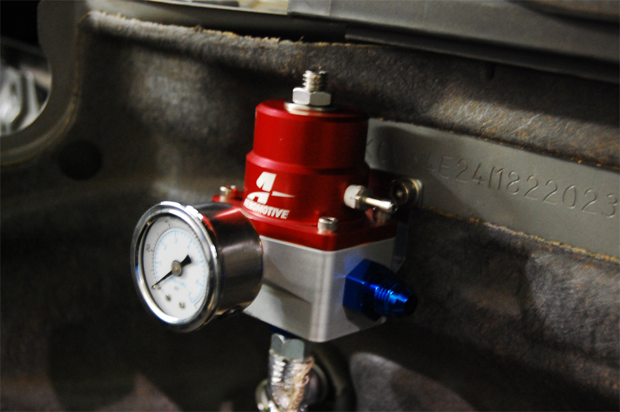

It's not mine, so I'm not entirely sure. But it's the same pressure regulator that I have, so here's a pic of mine. Only difference is his gauge is mounted near the plenum not on the regulator like mine.
The loose fitting in question is the one on the bottom (fuel input)

So take the regulator off. tighten it by turning the regulator and screw it back into the wall. if its not leaking its good. And btw, that line on the bottom is the return line, not feed. The fuel goes through oem hardline to the rails to the regulator and then to the tank.

they are all NPT threads and will start leaking if they are not tight. Mine leaked from the front as well. I used some tape on the threads and sealed it up. You dont want that one on the bottom leaking as thats the feed line. If you can move the fitting, you need to redo it
