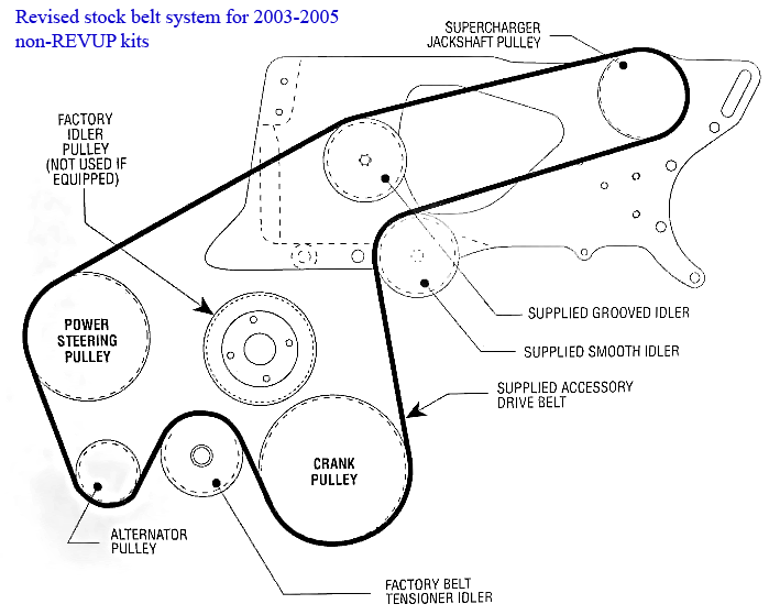

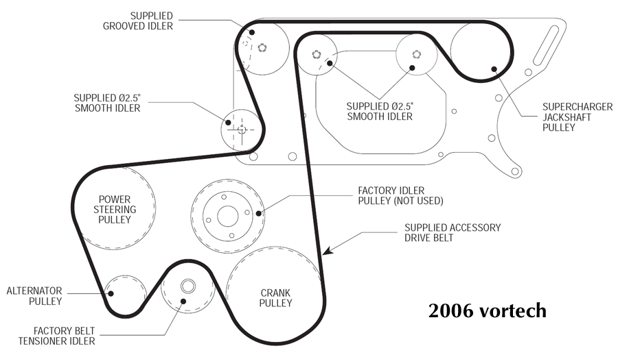

And here are pics of the brackets, they are shaped differently and fit differently on each particular engine.
Bottom line...the revup bracket will not work on a non-revup engine...
Originally Posted by j-velocity
I thought the difference on the bracket is the Revup kit got an extra hole while the non-revup doesnt.
Attached Thumbnails Quick question about Vortech-vortech_short_belt_non_revup.gif   Quick question about Vortech-2006vortech_revup.gif
