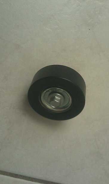

I used a different pulley but i've thought about switching to that focus pulley. What size bolt do you use with it? That was my only concern. I could'nt find specs on bolt size through their bearing.

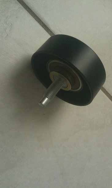

GTM Pulley Mod - I bought it from rockauto.com which came with a bolt and shield. I think it was 8M x 1.5. I have a pic at home that i'll post up for you.

Pics of pulley attached. It is definitely 10M x 1.5
Also, looks like I have the tension pulley installed correctly.

thanks for the pics. I might switch it out since it's slightly smaller than the pulley i used (60mm) so i'll have more clearance.
