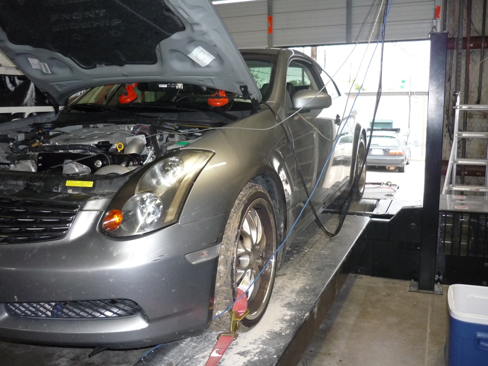

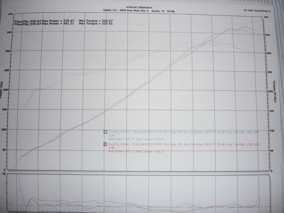

Final Tune: 370.37 Peak HP and 323.27 Peak TQ on a Dynojet.
I did the work except for the tuning in my garage with some hand tools. This forum was awesome. I couldn't have done it without the search function! Let me say that whoever says they can do this install in 8 hours is a freaking master mechanic. The clearances on this kit are SO tight that I am still amazed I was able to fit the piping in and that connectors aren't getting eaten up by the COG belt.
Jared at Uprev did the tuning. He was a stand up guy. Worked hardcore all they way down til the tune was done which was past 10 PM. Also, for anyone going to Osiris, the stock MAF maxes out really fast. We found out after the first run the maf had already maxed out.
A couple pointers on the install:
1. You can't change the pulley out with out pulling the blower, so definitely change out the pulley first, i learned the hard way.
2. Run the oil return line over the intake piping, the clearance is too small not to do this.
3. GET A CATCHCAN. It's really annoying to get oil blowing out the BOV.
A couple pics... Also, thanks again for all the help!

OP, how many lbs of boost did you see?

Little over six lbs, but the HFC's bring that down quite a bit and i was getting slippage on the belt, what a pain that was.

nice numbers for a 3.12 but i think your boost should be higher. i was seeing about 9lbs on my 3.12 with headers, test pipes, and full exhaust.

just tighten the belts. I had slip until i realized my belts needed to be a lot tighter. I used my 2.87 for a long time and was only getting slip past 11.5psi before i put my gtm pulley on. Anything smaller than a 2.87 you shouldn't need gtm mod to stop belt slip, just tight belts.

old thread but r u telling me that u ran ur oil return over ur intake pipe..god i hope i read that wrong cause that is ghetto, there is plenty of room to run it under and down...also u do not need the gtm pulley mod with the 3.12 pulley and u should see all of 9 psi with ur exhaust setup just tighten the belt..i see 10psi with berk test pipes, motordyne xyz and a nismo cat-back on the 3.12, and yes the pulley can be changed with the blower on
are u seeing that boost on ur boost gauge or on their screen? do u have a boost gauge in ur car?

I do have a boost gauge in my car and use their program to see it as well. They match of course since they tap off the same line. The boost has gone up near normal since the GTM pulley mod. I didn't want to over tighten the belt since the startup sounded a bit strange.
