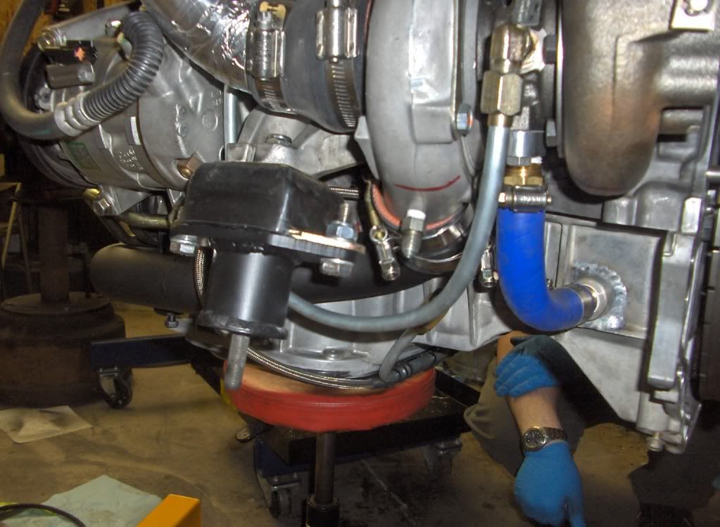

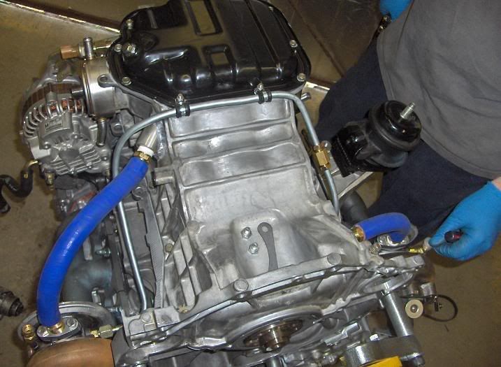

A good look at my drain line prior to install
shows both drains..
I can get some more pics in a little bit. Not sure what ones will help most though.

I've never seen oil return at that location on the VQ.

+1. That driver's side return is much further back than every other setup I've seen. I'm not sure if that's a place where oil pools or not... Perhaps phunk will know.

well i guess neither had we lol. But it looked legit when we were gettin everything ready. But if that drain location isnt working properly then why after 15,000 miles would it just now start smoking?
rcdash- That is something i just started thinkin about staring at the pictures. I wasnt thinkin about pooling oil. we just figured its above the oil level so it should drain fine.
