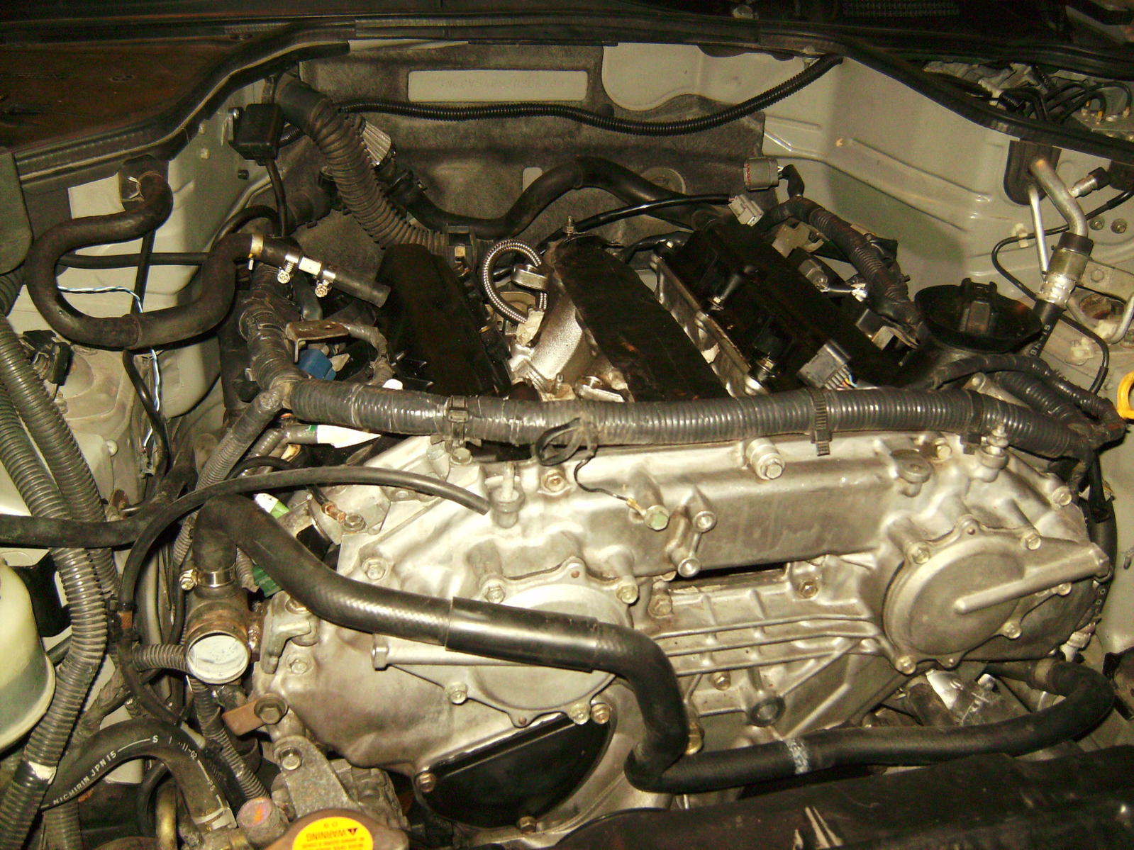

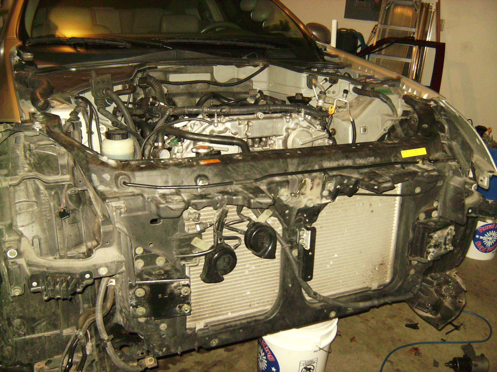

I have the motor in, harness wired, and oil in the car. My soon-to-be wife wanted to spend the evening with me since i'm working the next 2 days at the hospital so I stopped early today. I also wanted another day to see if i can fix the BPV.
All I can say to nissan is SERIOUSLY? Millions of R&D and the engineers decided THIS is the best way to wire up this car? holy crap this is a rats nest of a wiring harness. I'm so glad that part is done.
I am horrible at pictures. There really isn't much to show since it looks like the same engine in the car as before. Cosmetically it hasn't changed other than it being clean.
