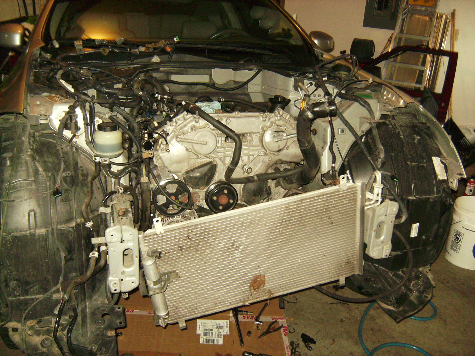

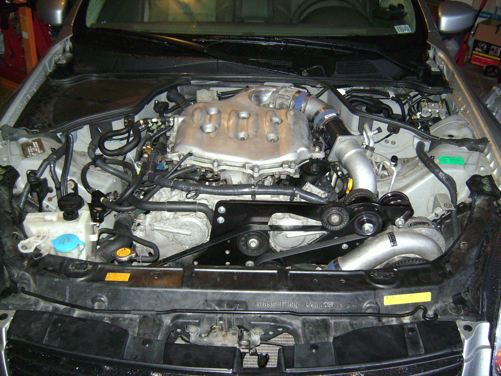

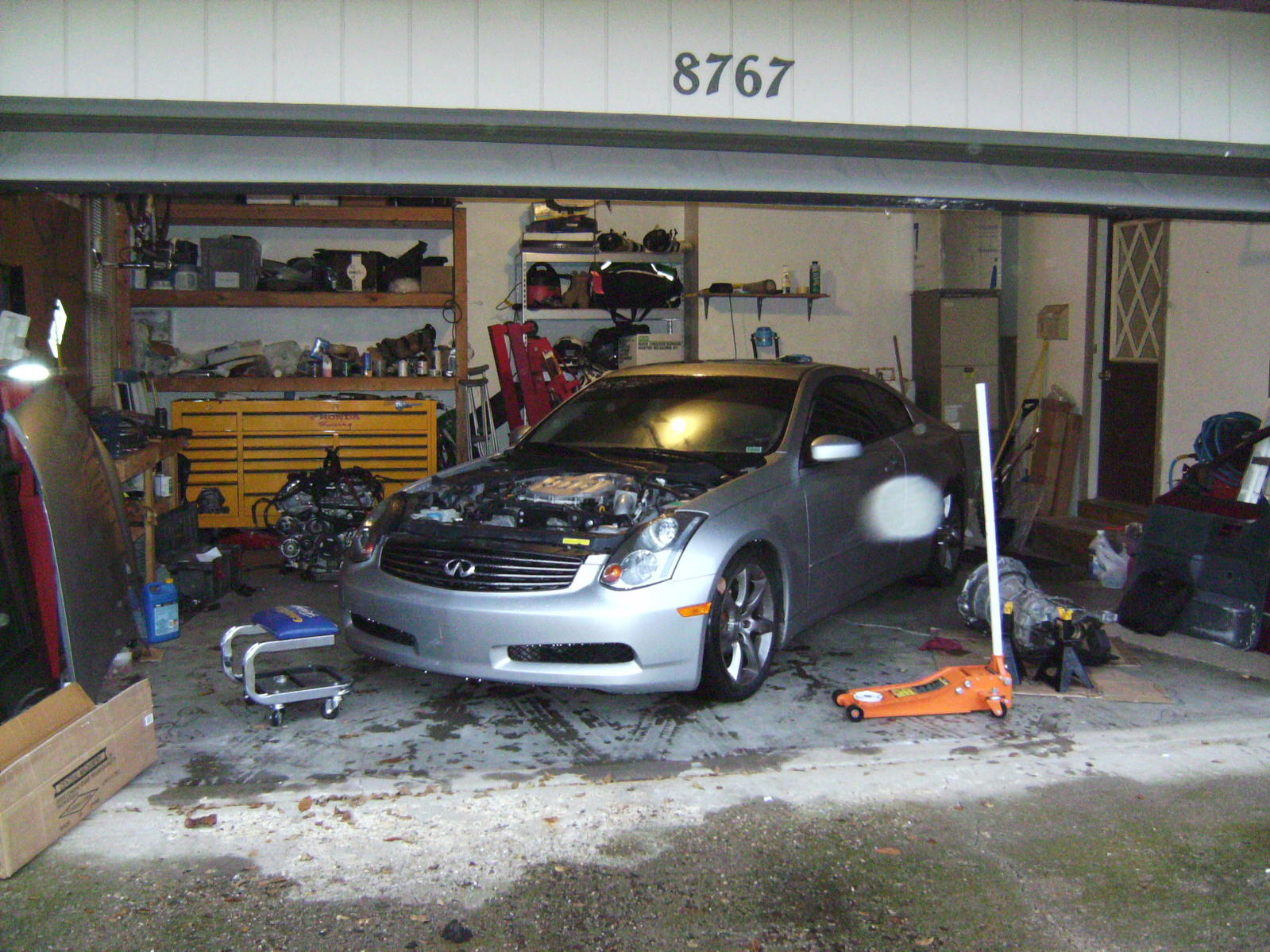

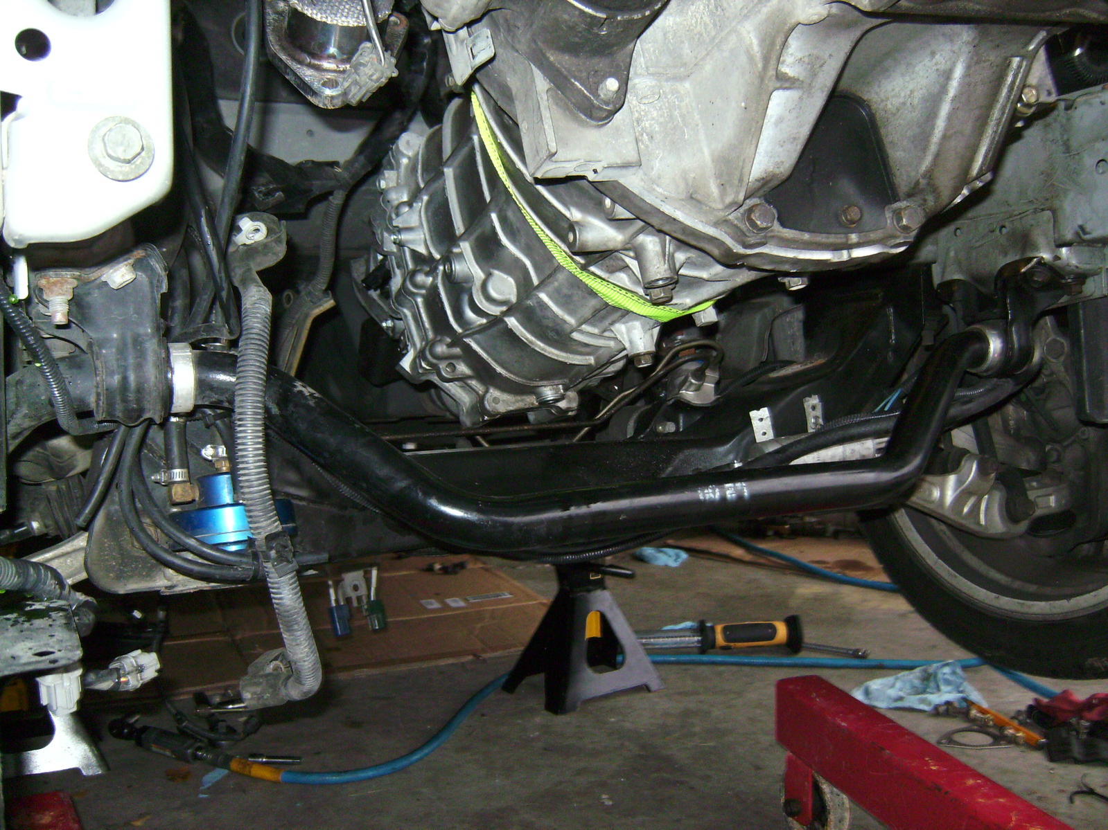

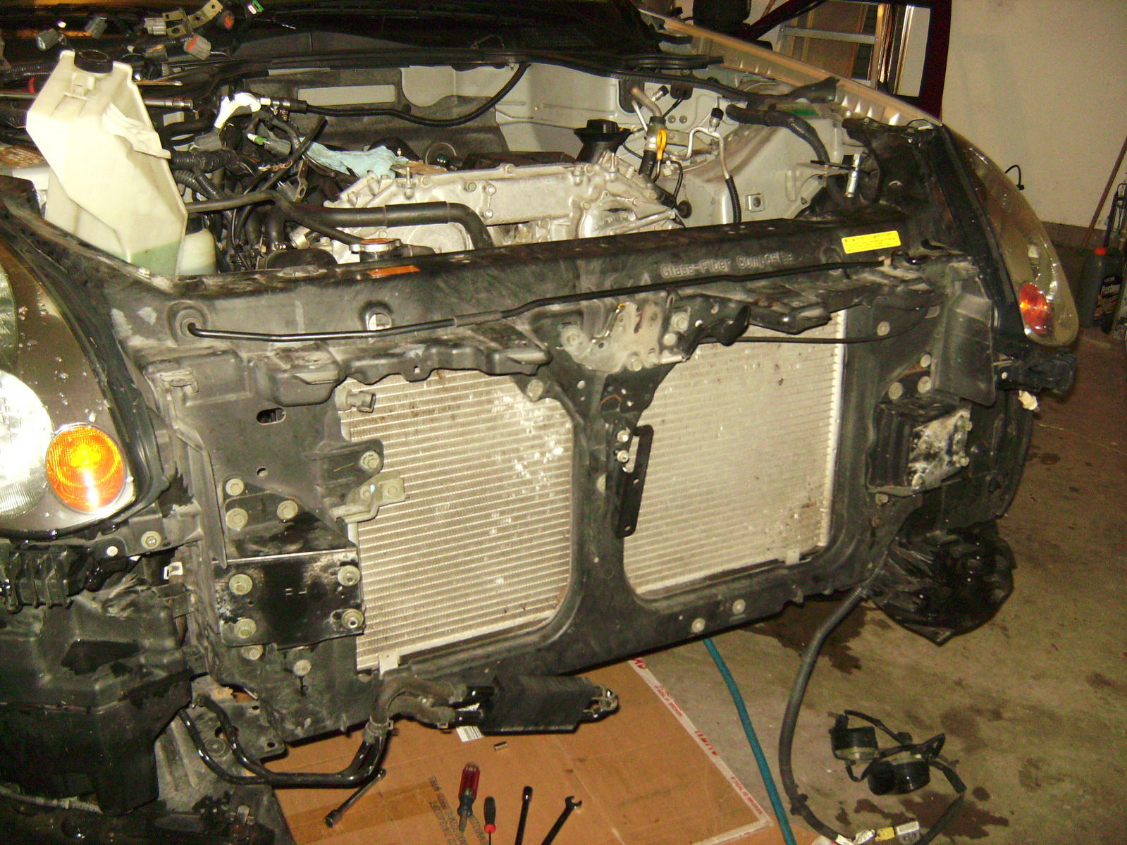

So earlier this year I installed my vortech. Of course I decided I wanted more. I fell into a great deal on a built motor along with heads.
Here is the rundown of the motor:
arias extreme duty 9:1 pistons
pauter rods
arp headstuds
ported heads
ferrera valvetrain
tomei 264 cams

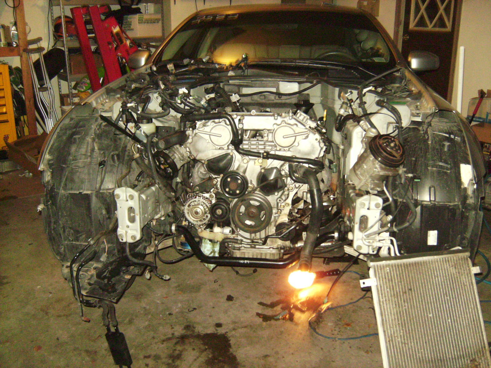

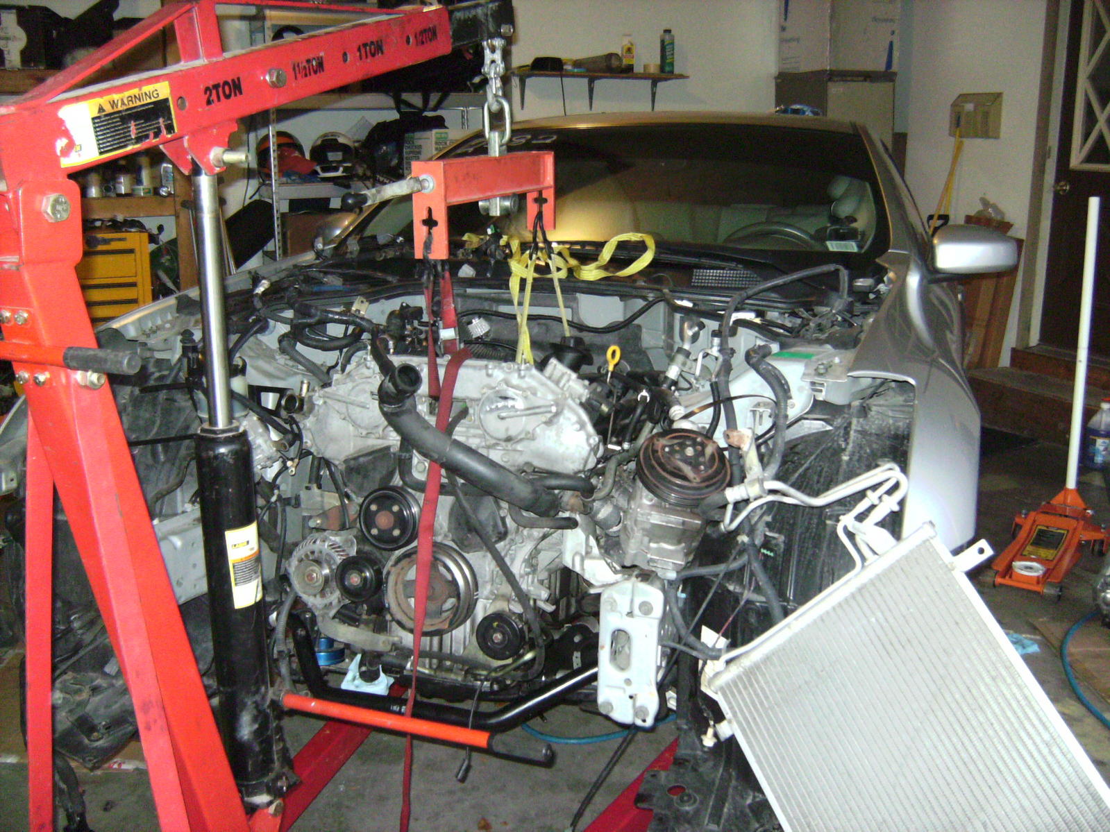

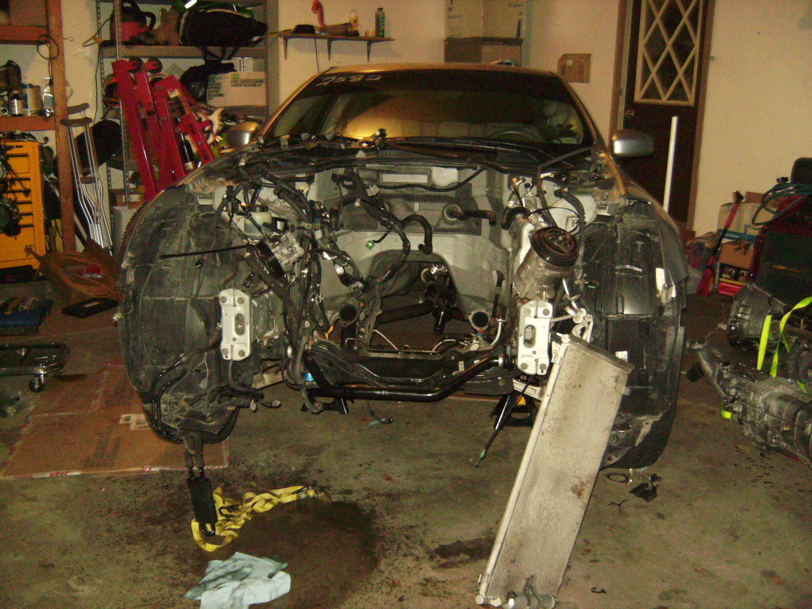

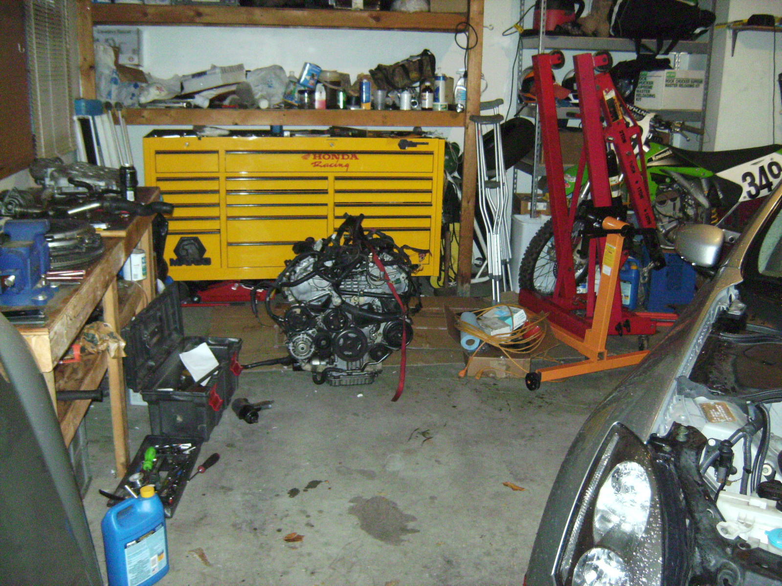

Here are some pictures of my progress. I started yesterday getting things pulled off the motor and today I pulled the stock motor out.

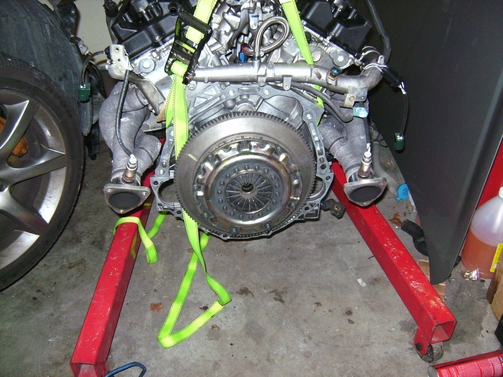

There are way too many sensors and wire connections on this harness! My fingers are so sore I can barely type this out from pushing on those connectors to get them loose.

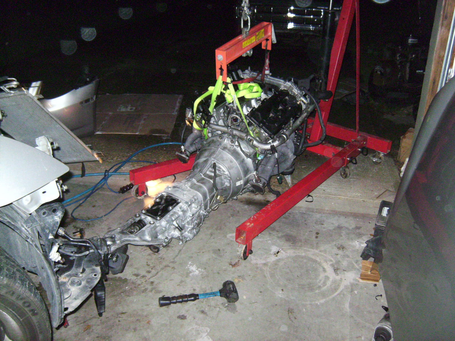

I had a strap break when I started hoisting the engine/trans out. Thankfully when it came crashing down it didn't hit any of my powersteering lines. Total suck.

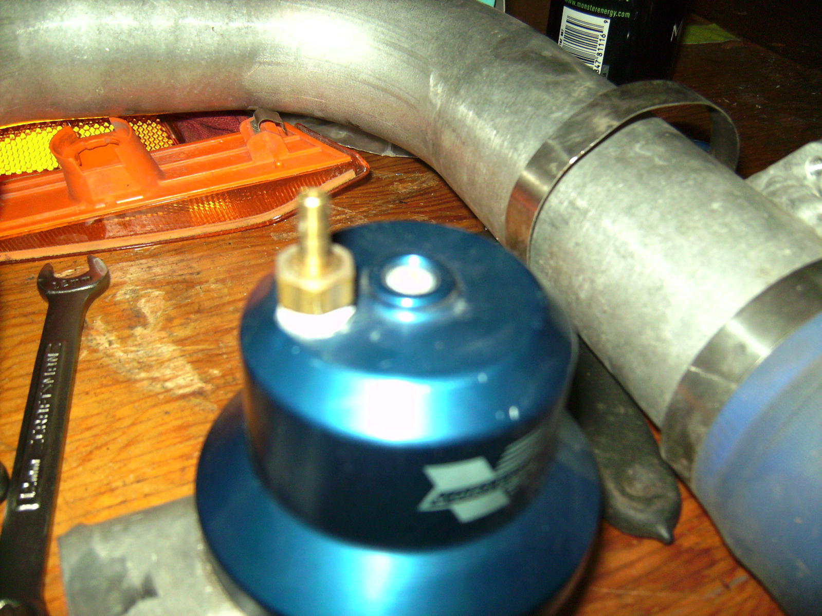

I also found that my BPV for my vortech has the adjustment screw broken off. Any suggestions on what to do to replace that would be helpful.
It's a little tight in the garage....had to put the car in there diagonal to make room for the toolbox. lol

you shoulda left the radiator/ac condenser/front brace all as 1 piece

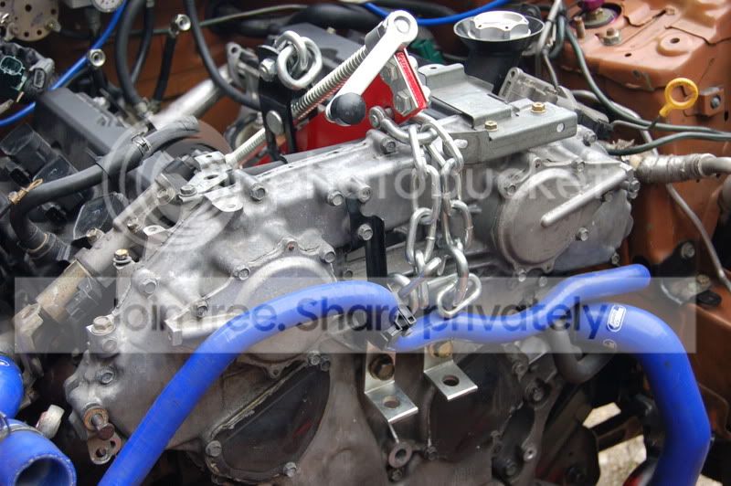

and some advice, dont lift your motor like that. You are really lucky you didnt cause a few g's in damage when that strap broke.
use the 2 bolt on the front of the motor and then 2 of the bell housing bolts.
Here's a clearer shot from from rrmedics DIY
ah, that would have been awsome but i am trying not to open the a/c up. The infiniti dealership i trust is 2 hours away (the closest dealership actually) so i'm trying to save myself a huge setup in charging the a/c properly. It did make some extra work for me but i'll know my a/c is still going to be working perfect when i get it back on.
Ya, i know. I've lifted a few like this and it's not the best way by any means. These motors aren't near as easy to hook onto as the chevys i'm used to. How do you get to those rear bolts with the chain? that was my issue with bolting to them.

charging the AC is simple and costs 25$ (3 cans of refrigerant at $7) you can borrow the manifold gauges and vacuum pump from autozone for free. its not worth 30$ to risk bending/breaking hundreds of dollars in AC lines. But its already done.
I just attached the L brackets from my balancer right to those bolts. and threaded them right back thru the bellhousing and the motor. it shoulda been obvious when you were pulling the motor out
Having it evac'ed and charged properly definitely isn't 30$ here in this area. I don't trust small repair shops either. The "supposed" leader on a/c here in the area took 3 visits and over 200$ to finally get the a/c working on my truck only to have it fail less than a year later. So ya, i'm reluctant on having it messed with. The dealership will fix their issues if they don't do it right, but that takes a 2 hour 1 way drive for me to head back to them.
So you crawled up from the bottom to get to those bolts? Those were a pita when i took the trans out to change my clutch. I don't know if i could get my hands up there to put a hanger bracket on the bolt.
I guess i could put it on there when re-installing so all i will have to do is remove the bolts from below and let the hangers fall out
str8, do you know anything about replacing the adjustment screw on the BPV? mine oddly is broken off. I can get it out, but i'm not sure what to replace it with or if vortech even offers a replacement. Also, the oring for the BPV goes on the sealing face of the disk. Mine keeps coming off the sealing side and going behind the disk around the shaft. how do you keep that oring on the sealing face inside of the bpv?

either way... it was easy to get those bellhousing bolts from the top of the motor. theres alot of room. If you didnt take your plenum off, thats might have been why it wasnt so easy.
if your o-ring is moving, thats a surefire way to get a mess up tune. My 1st BPV did that. Sent it back and they sent me a new one.
As for that bolt, again, prolly have to sent it back. You could try to pull that cap. Maybe its just a threaded rod, but i think its actually attached to the plunger.
If its set properly, it prolly doesnt matter. You should not have to ever touch the BPV.

str8, that sucks, i'll call vortech and see what they say. I'm sure as heck not paying the 200$ they charge for a new one! I'm really not worried about the adjustment. I set it at 6 threads showing and it seemed to work fine. I'm more concerned about this oring not saying in place. I don't see how it is supposed to stay on the face either. It just flops all around when it put it there and the BPV is manually opened it. It doesn't stay in place.
