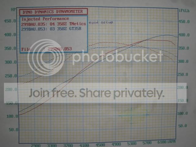

hmm lets see, Jeffie's PL single fully spooled by 3000 rpms. And thats on a dyno, it will spool faster on the street! Show my any APS dyno where they spool much better than that, better yet, show one "thats not even in the same ballpark!".

And dyno dynamic dynos are load based and the load can be modified so you can artifically spool a turbo sooner on a load based dyno.
I doubt his low end curve would look anything like that on a dynojet.

heres a 9psi dyno of my car from 3 years ago....completely stock motor
No lag since it's competely linear and the torque holds on longer...much more area under the curve vs the PL GT35R...

Edit:
Furthermore, Jeffie7's dyno does not seem to be at all representative of PL (nor any other) ST kit dyno. Take for instance this dyno, showing both TN and PL... notice the torque deficiency (still on the same type of load bearing Dyno Dynamics dyno). At 2500rpm the PL kit is down about 75ft-lb, the TN is down about 100lb-ft. At 3000rpm the PL is down 75ft-lb, the TN about 110lb-ft. At 3500 PL down 50ft-lb, TN down 75lb-ft. The more i look at it and research other PL numbers, the more it looks like jeffie7's dyno has the load cranked way up on it which will cause much earlier spool than you'd see on the street. I don't believe that jeffie7's dyno is at all representative of real world ST dynos, and it's still inferior to the TT curve.
