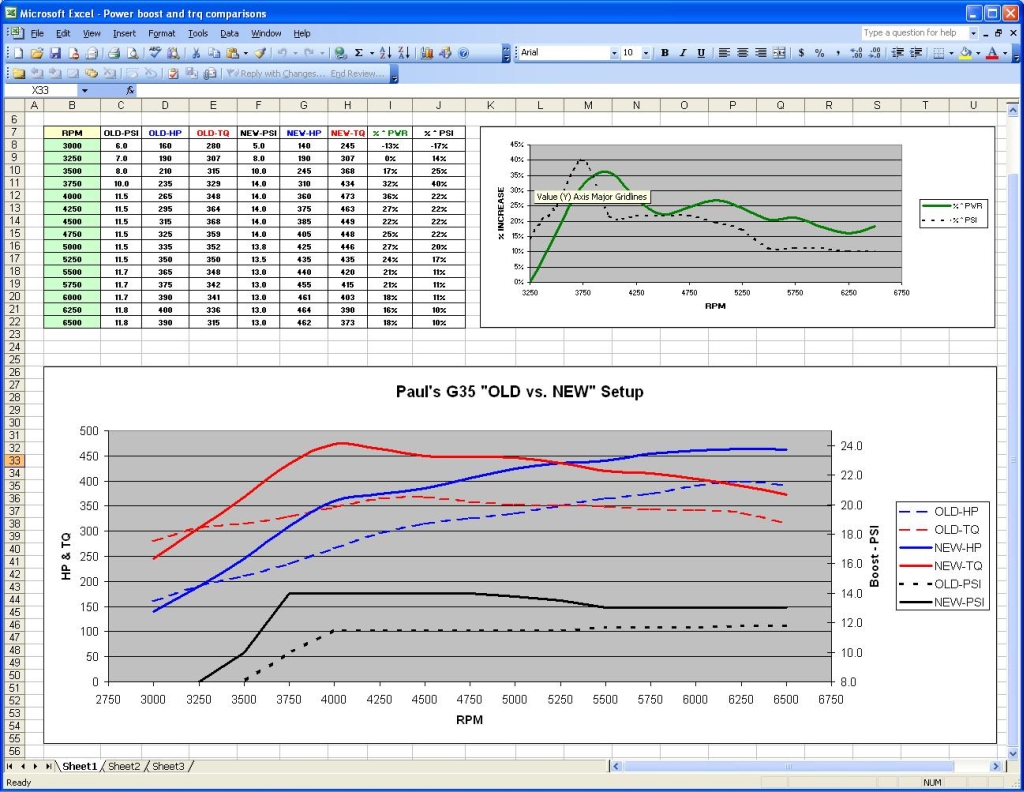

I don't think the dyno's I have from forged will help us compare. When I had the cams installed, Sharif also did a lot of other mods to the car (FCON, 3" APS delete pipes, forge actuators, complete tuning, Evott exhaust).
I still have the original excel spreadsheet that shows the difference in Power from my original GRD setup (stock cams, unichip, 2.5" APS deletes & exhaust, 11psi) to my current Forged setup (BC stg-II cams, FCON, APS 3" delete, EvoTT, 14psi).

so ur running just over 450whp at 14psi with cams?? just to be clear, this is with the aps single turbo kit?
aps twins, the original aps kit.
Actually I'm now up to ~512whp DD at 15psi. Sharif has continued to tweak the tune over the past two years
