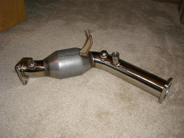

Originally Posted by g-Know
My bad. Didn't think about the cats being so far up. So the cats do have a pre-catalyst the bung can go onto?
no u have to have a bung put on so u can screw another sensor in that comes with the wideband...heres a pic of a bung put on a berk high flow cat pre catalyst..would be the same for a stock cat
some test pipes come with the extra bungs already with plugs in them to use if u want or leave plugged...berk test pipes already have the bung as well as some others...when i ordered my berk high flow cats though i had them weld another one on pre cat for an extra 20 bucks before they shipped them to me such as this picture...
