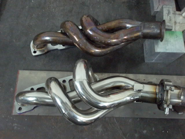

i think what needs to made clearer here is that this is mostly a case on a production product... custom made it can be made to fit... ovbiously shotting for 1000+hp you cant just go with all off-the-shelf ... IMO
here is the one i had custom made compared to a nismo

Jorge.......so you are saying that its possible to get a Tube setup to fit with the turbos in the same location as the log?? If so,,,thats something I am willing to do
Not sure that'd work. Jorge's setup is a big single, so it just has the crossover piper instead of a turbo. Maybe I'm wrong

ya but there is no reason for a VQ to have such complicated headers, and thats for a twin scroll setup (basically TT piping going to 1 turbo). the ones that SP and SFR make are simple, bc there is no reason to make them otherwise. turns are bad.
Ya the collector design could be better, but they arent making 4 banger twin scrolls manis.
yah, mainly...i was addressing the statement that there is no space and it cant be done...and my point is that people shouldn't just assume it cant be done, not quite feasable to do it with production kits(sure), but custom is possible...... the TT gt37r turbo Z from also uses custom headers
From what I was told... A custom tubes could be done... But not even the 530bb would fit in the spot where the cast setup sits....the turbos would have to be positioned the same way as the SP/SFR..... But as I have said before.... That's not the kind of performance i am looking for.... So log it had to be.
There is a guy a few houses down from me that has a TT Lambo. He has almost no lag... Or way less lag that I have with my Tube setup.... Because has TT is mounted right up on the motor where mine is out to the side. Rear motor cars have way more room to play with ... So they plan to do mine like the Lambo....I guess the same would apply to the G/Z .
