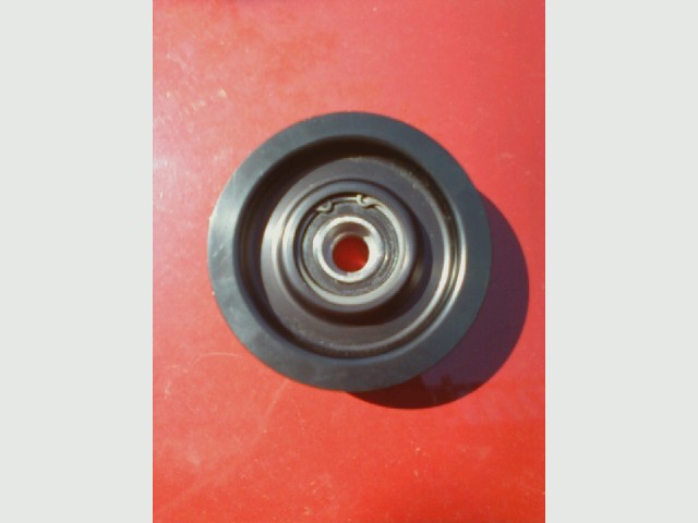

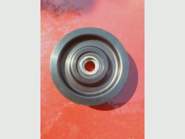

heres what i have if u need...brand new never used...ill have to find out how much they are new cant remember what i paid for it, i ended up not needing it..think this is the pulley u are saying you need

Default That's it!
Woot! Let me know how you want to handle this.
