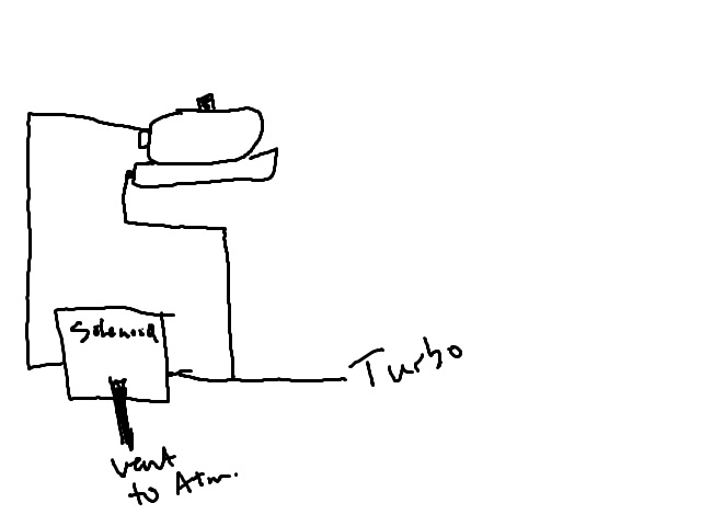

here's a diagram of how i have it plummed.
sasha, email with haltech map sent to you already.
Attached Thumbnails Strange turbo smoking issues, turbo guys help-wastegate.jpg

This is how it hooks up:

ya, that's how mine is in the drawing right?

Yup, that is how my is set up.

If you are seeing 11psi, on a 7psi spring, good chance thats boost creep. What size is the wastegate?

38mm tial. at that boost level it shouldn't be creep.
plus my wastegate isn't even opening at all. it's open dump so i would hear it open. There is zero open, the only thing that stopped my boost was the overboost protection from haltech.

Sounds like a boost control issue. The gate should open, and you would def. hear it.
If the hoses are doe right, you may have an electrical issue. The selonoid polarity does not matter when pulling the wires from the Haltech, as long as they are the correct wires.
I would get the car up and just run a hose from the lower wastegate port to the turbo compressor and see what happens. It should hold boost at spring pressure.
