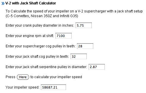

Originally Posted by ramirj2
^ Anything smaller than 3.33 will spin the blower faster than Vortech recommends.
That is True only with Zero Belt slip. Many people on my350z spin there Vortech Faster that recommend, based on No belt slip.
Remember, there is always some belt slip with a Serpentine setup
My set up is a V2 SC trim 7100rpm, 28/32, 2.87 on an 2003 VQDE.
Over 40,000 miles with this set up, plus Drag strip Time...
Attached Thumbnails My T-Trim Tuner Kit Install-screen-shot-2010-07-19-at-1.38.10-pm.png
I know you are one of the most experienced here and fastest.
If you were in my situation, what would you do?
Would you put the T-Trim and the ATI without any valve?
If you already have the Limiter Valve, I'd install it.
If your very concerned about the blower speed, you could go to a 30T on the back of the jackshaft. (4GR032-03 30 Tooth Count Jackshaft Pulley)
Or, You could start with the stock crank pulley, 28/32, and 3.33 (47,018) and see what kind of power and boost your making.

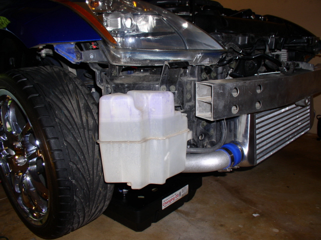

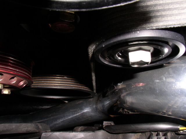

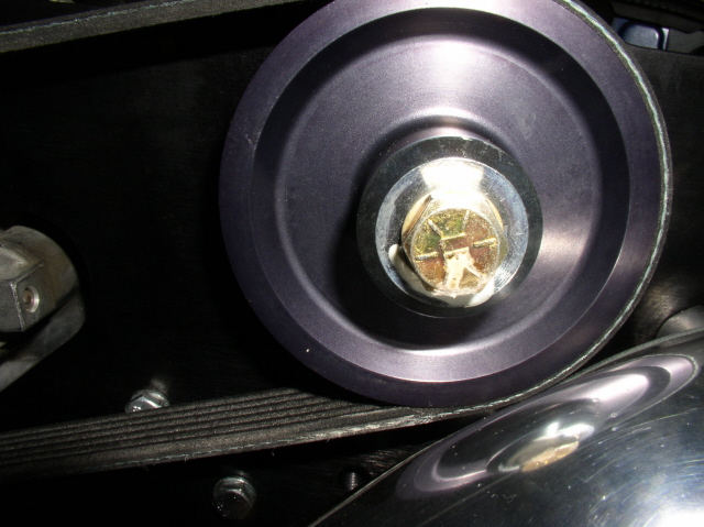

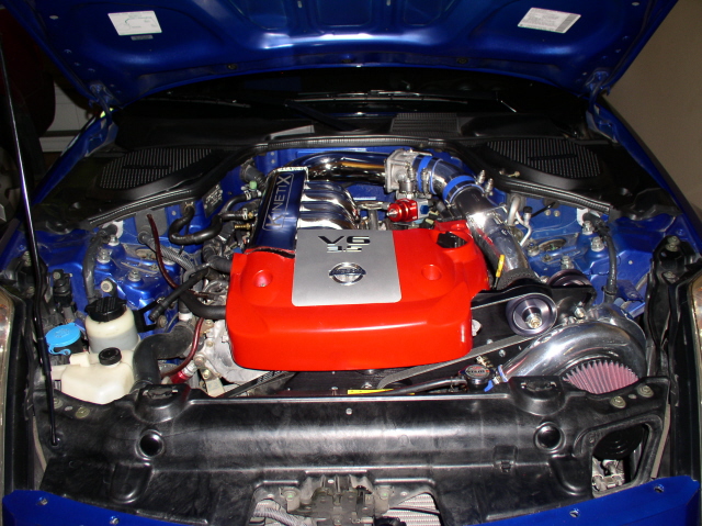

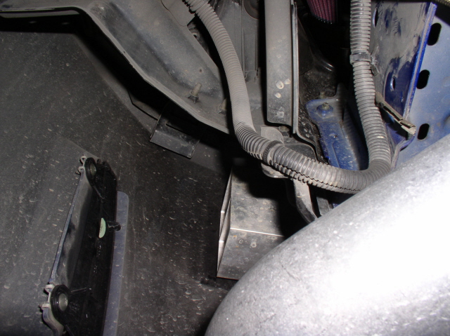

Update!
I made a quick change in plans. Installed the kit with the stock pulley and leaved the ATI and BLV valve for latter use, after having a taste for the kit. Not finish yet but at least the hardest part is done.
After the install notice how close the discharge pipe is to the crank pulley. That ATI would be a very thigh fit.
Do not have a caliper to measure this pulley but to me from the circumference it roughly measures the 3.33”. There is a post in this thread (and I have read it before ) staying that the 3.12” came standard with the T-Trim and the 3.33” will not fit due to the larger blower.
Need to install the catch can, bung to the cat, map sensor, tuner reg, oil cooler and gages.
Having no time sucks!
Have 2 options to install the oil cooler, at the driver side below the head lamp or at the passenger side replacing the wiper fluid reservoir.
I prefer to replace the reservoir.
Is there any way to get rid of the low fluid warning light if I do it, other than taking the light out of the gage cluster?
I do not use that thing anyway and 10 pounds less in the nose of the car are always welcome.
Attached Thumbnails My T-Trim Tuner Kit Install-install-12.jpg   My T-Trim Tuner Kit Install-install-13.jpg   My T-Trim Tuner Kit Install-install-14.jpg   My T-Trim Tuner Kit Install-install-15.jpg   My T-Trim Tuner Kit Install-install-16.jpg
Old Aug 13, 2010 | 04:36 AM
GT-ER's Avatar
GT-ER
Joined: Apr 2009
Posts: 769
From: Puerto Rico
Looks pretty! What dyno are you going to take it to?

u measured at the belt interface and not the outside face right?
you can bolt the cooler right to the bumper brace and not move anything.
for the WW sensor, just unplug it from the tank, and there will be no light on the dash.
ya, bolt the cooler straight to the crash bar. There is PLENTY of room to keep the washer tank.
and thanks for the unplug tip rich. I keep mine empty because that's 8lbs i save (that i don't use) but the light was getting annoying.
I measured the circumference at belt interface and with the circumference formula, calculated the diameter.
Any way lets see the dyno and then will decide what to do.
Thanks for the tip on the ww sensor, will take it out and put the cooler there since I do not use it.
