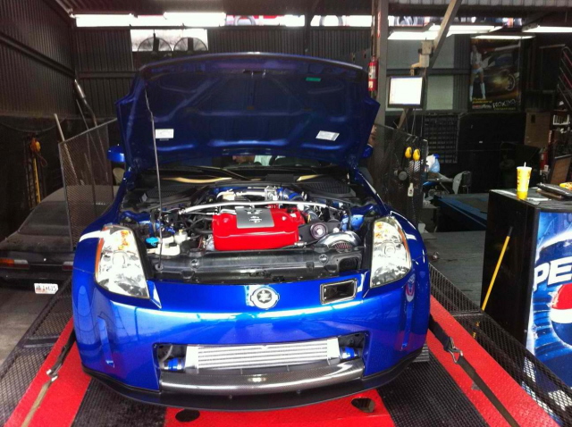

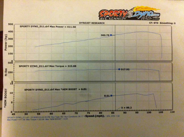

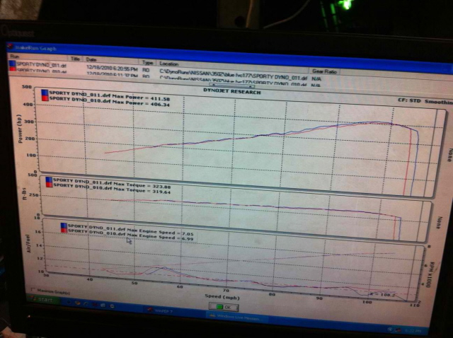

Back from the dead!
Finally finished this thing and yesterday went for a tune.
This is a T-Trim kit stock pulley and I’m very pleased with the result
411.58whp and 323.88 ft-lbs. at 9 pounds.
After 5 months down, the car just started right up and drivability is almost stock.
Now moving into my 2nd project and new DD a Genesis coupe R-spec.
Not going to waist time in that one and plan to do a LS2/LS3 swap in a couple of years.
As for the z I’m very pleased with the result AF is low 11’s at WOT and no knock whatsoever.

You will like the feel of the car with AFR's closer to 12.0, with a hair less timing

looks to me you have a little bit beltslippage at the highest rpm.
you can see boost and power drop a bit at the end. they should keep climbing till the end.

yeah the boost curve looks like slippage to me also..
