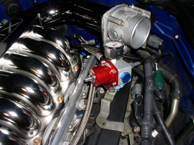

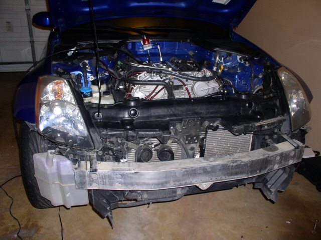

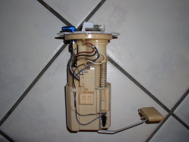

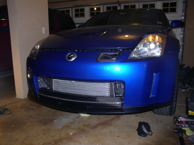

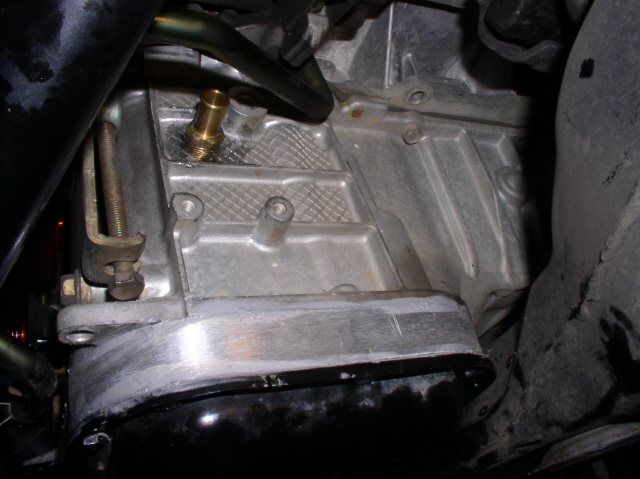

Here are some pictures during;
Already AAM return kit in, oil pan spacer , walbro , sparks , oil return fitting and started to fit the intercooler

I doubt you'll have to even use that valve. They are waste of money on a pulley setup.
At 6500 rpms, the impeller be at 55,000 rpm, so thats a nice start.

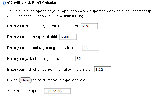

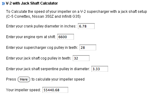

I understood it was supposed to come with the 3.12 but I measured it at 3.33, will measure it again.
T-Trim max speed is 55,000
Remember that the ATI measures 6.78
According to Vortech formula with a 3.33 should be at 55k by redline.
About boost levels, I would be looking at the peak torque not boost, 380-400 max.
Crank Pulley = 6.78, cog setup 32/28 and redline 6600
SC pulleys and RPM
3.33---- 54365.65251
3.12---- 58024.87912
2.87---- 63079.3111
2.62---- 69098.32933
I removed the crank pulley bolt, but have not swapped it. I have the UR in the motor and have the stock pulley and the ATI so I can put the stock without the valve or put the ATI and valve, will think about it…

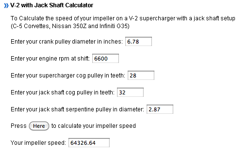

Per Vortech
Attached Thumbnails My T-Trim Tuner Kit Install-screen-shot-2010-07-19-at-12.01.12-pm.png   My T-Trim Tuner Kit Install-screen-shot-2010-07-19-at-12.01.34-pm.png   My T-Trim Tuner Kit Install-screen-shot-2010-07-19-at-12.01.51-pm.png

Originally Posted by OldManZ350
Per Vortech
^ Anything smaller than 3.33 will spin the blower faster than Vortech recommends.
