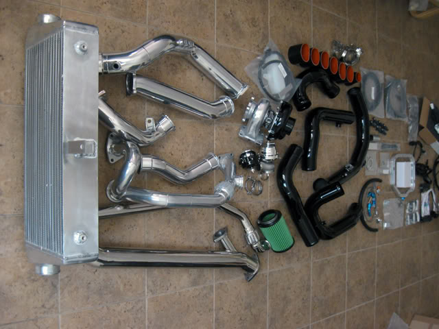

PowerLab kit impressions:
I looked into a few kits but after seeing the PowerLab single turbo kit in action my mind was pretty much made up from the beginning. And recently, I came across a great deal on a PowerLab GT35R Turbo kit and having no self-control, I jumped on it. The kit I purchased was the complete GT35R kit (minus the UTEC); standard equipment included the TiAL b.o.v., TiAL wastegate, Deatschwerks 600cc fuel injectors, Walbro fuel pump, etc…
All together it took about a weekend to install this kit in the garage with basic tools, a fairly simple and straightforward process. I was thoroughly impressed with the quality and fitment of this kit and based on my experience I highly recommend this kit.

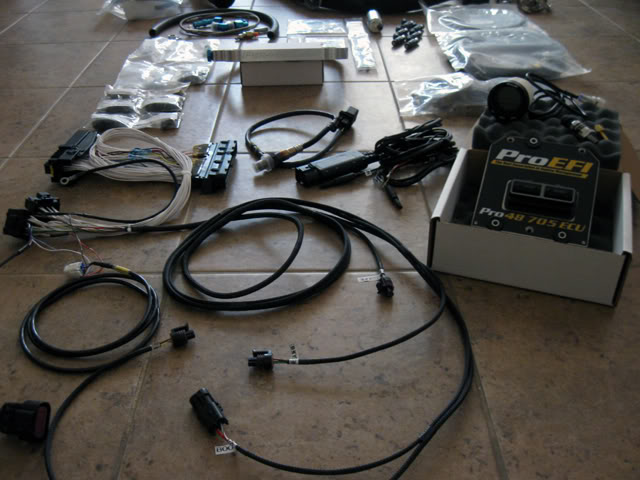

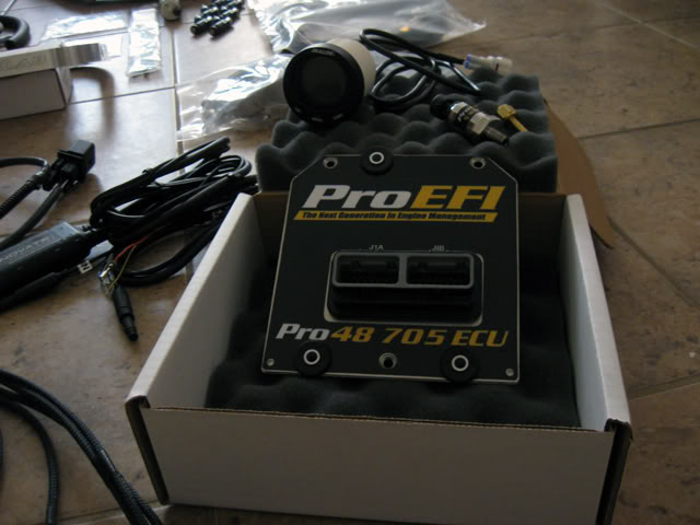

Engine management selection:
As far as the EMS I’ve chosen the ProEFI Pro48 ECU (along with VQ plug and play harness, 5bar map sensor)…I’m ditching the UpRev Osiris software, I feel more confident having the ProEFI controlling everything. I also opted for the fuel pressure sensor and ProEFI can gauge to monitor everything.

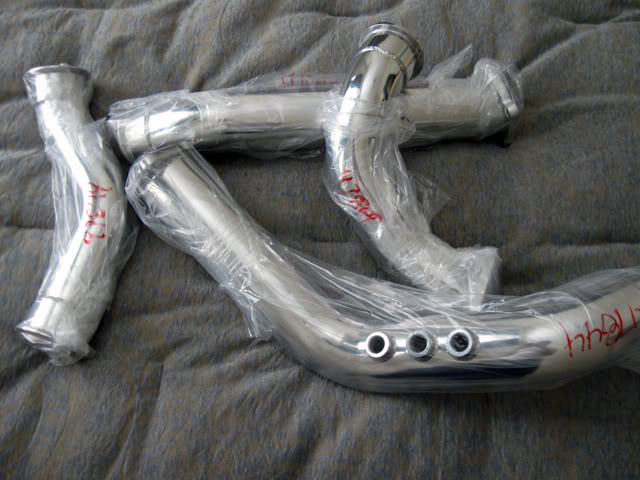

Coatings:
Also, I recently sent the exhaust side piping and hot side of the turbo housing to Jet Hot for a thermal coating, and the charge piping and cold side of the turbocharger was powder coated a glossy black before I picked up the kit.

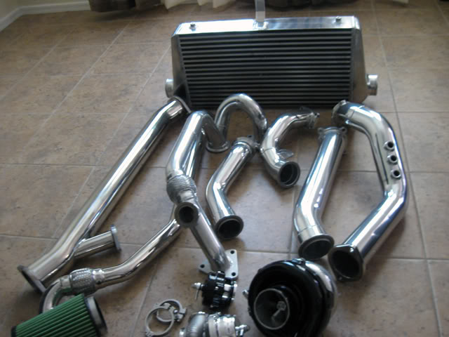

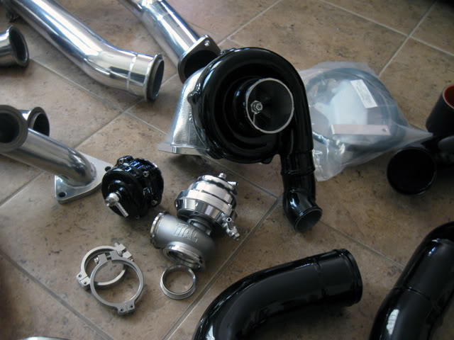

PowerLab GT35R Kit:
Turbo piping and housing back from Jet Hot:
ProEFI Pro48 EMS:

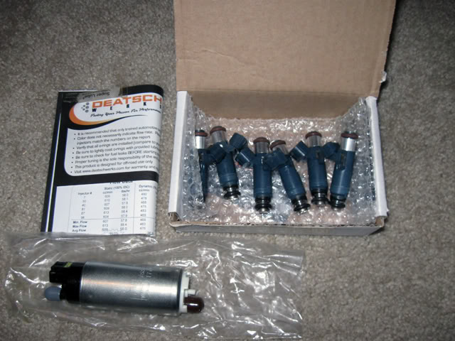

Fuel:
