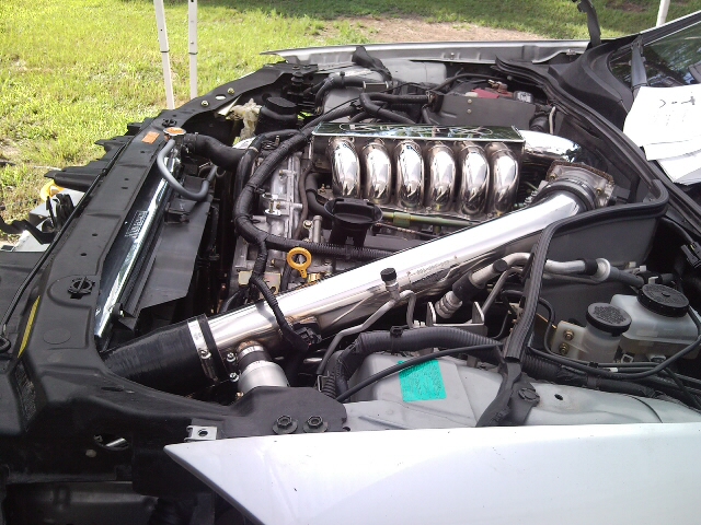

Bump for an update:
I started the install about lunch on sat and now the engine is back in and running and im in the process of bleeding the Coolant, heres a pic
Old Aug 17, 2010 | 04:40 AM
Boost_newbie's Avatar
Boost_newbie
Joined: Jul 2010
Posts: 18
From: IntehG
ok so the car is done and running GREAT!
it pulls like a train, BUT this could be due to me pushing 11.5PSI????? the only thing i can think of is that the previous owner installed the boost jet the kit comes with. Does anyone know where this is located, i havent had time to look through the install manual and try to find it, and if it is installed would that be causing the problem? my AFR is good right around 10 and should be making mid to high 400's, for know if i just cant resist a little boost i just short shift at about 5.5k
any advice is greatly appreciated
Edit: could it be something to do with the boost control solenoid? im not sure how exactly it works, could it be a bad ground on the solenoid or something like that?
