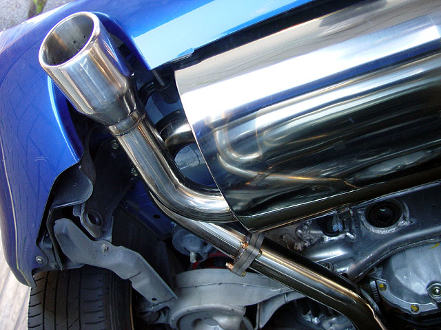

I'm so lucky living next door to APS, well not right next door but not far away, next suburb. My car is now proudly kitted out with the all new APS Stainless Steel Dual Catback exhaust, the fit and quality is fantastic it's a shame its all under the car except for the tips, which are a work of art in them selves. Some back ground info before we go any further, my car was fitted with an Australian HiTech Catback system which I loved, it developed extra 15rwkw and sounded pretty cool but as I was ordering the ASP Twin Turbo kit I wanted to have the complete APS system ie; exhaust to match the TT. Let me say that I was not expecting it to perform well on a NA car, boy was I wrong the car seem to be very responsive to the throttle and my bum says its quicker it pulls much harder, I’ve had no time to get it on the dyno yet will try to post results as soon as I can. There is no droning that I can detected at any speed and on a light throttle you can just hear it above the engine, but on WOT it sound very much like the 996 Porsche, just awesome. I particularly like the four bolt racing style stainless steel flanges and the attention to detail, like being able to refit the air deflector from the OEM muffler (which I haven’t had time to fit as you can see in the photos) and keep the car’s aero dynamics as close to what the Nissan engineers designed for this car’s. All in all this a great exhaust, a well thought out top notch system, if this is a taste of things to come I can wait for the TT.

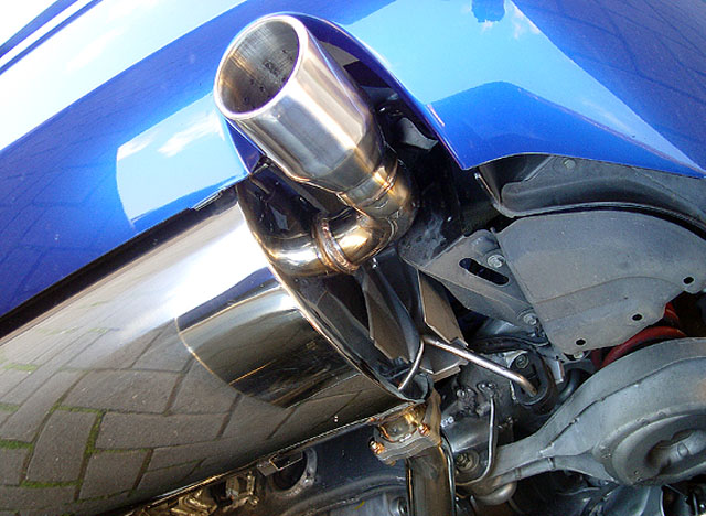

Another image - taken using a large mirror - no hoist sorry.

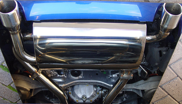

Another image - I will try can get some photos of the whole system later and post.

That's an interesting looking system. The left side tailpipe goes into the side of the muffler and the right side tailpipe goes into the front. I'd like to know what the path looks like inside the muffler.
I would guess they are separate because the muffler is huge, and the right side extension (tip) comes out of the rear side muffler, the same as the left input tail pipe.

weird setup, it is not true dual exhuast.
Lou
Correct both inlet pipes (left and right bank) to the main muffler are seperate and exhaust gases run through seperate perforated 2.5" inch tubing which are contained within the main muffler...........this way the exhaust gas flow is awesome and the back pressure is extremely low.
Just to confirm the gas flow.........the left exhaust bank exits the right tail pipe and the right exhaust bank exits from the left tail pipe.

Great to know you like the APS cat back.......it feels like it took forever to develop though the end result justifies the huge effort.
Looks like the MSRP will be $1195 though I'm positive when you see and hear the system (the exhaust note is awesome in the higher RPM range) for real that you will see the value in the product.
I just love the 4 bolt race flanges (made in 304 stainless steel) this eliminates any chance of exhaust gas leaks and the system goes together like clock work.
