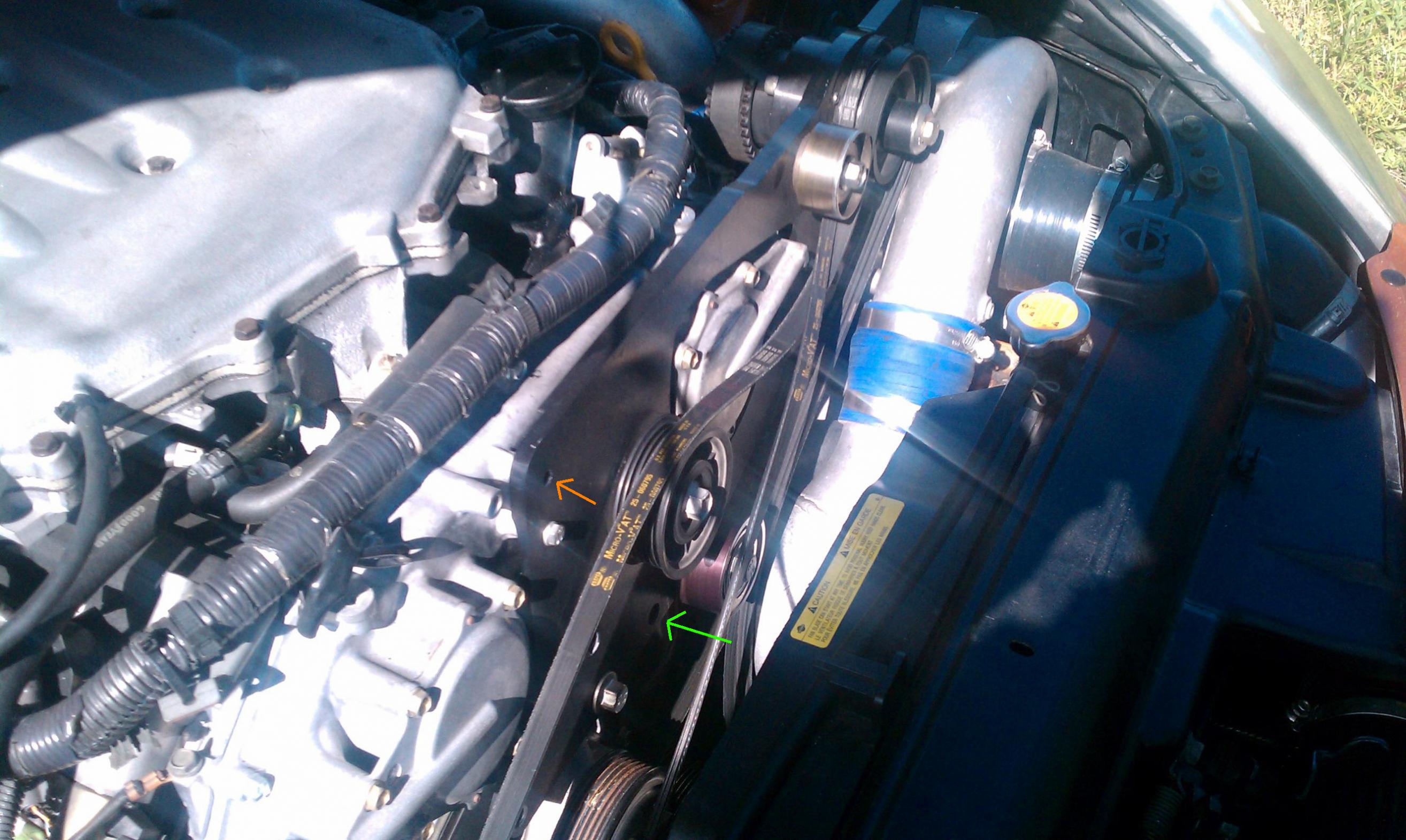

Found the problem. Went to reinstall the new belt and I noticed that my tension pulley was gone. How the F**k did that happen? The pulley bolt was there but the pulley was gone.

^ are you referring to the tensioner on the passenger side of crank pulley?
btw, you're also missing at least 1 bolt on your bracket.

Yes that's the one. As for that bolt, all the bolts that came with my kit were checked off and accounted for. Although I thought the same thing when I installed it. Looks like there is more than 1 available mounting hole.

see attached. definitely install the bolt in the hole marked with the orange arrow. also, i don't know if it matters much, but most people with the revised belt layout install the larger bolt in the hole below the grooved idler (marked with the green arrow). that's the way its shown in the vortech installation manual.

yep, so the tensioner bolt tore the belt in half. I knew something had to be up for it to break down the middle like that.
