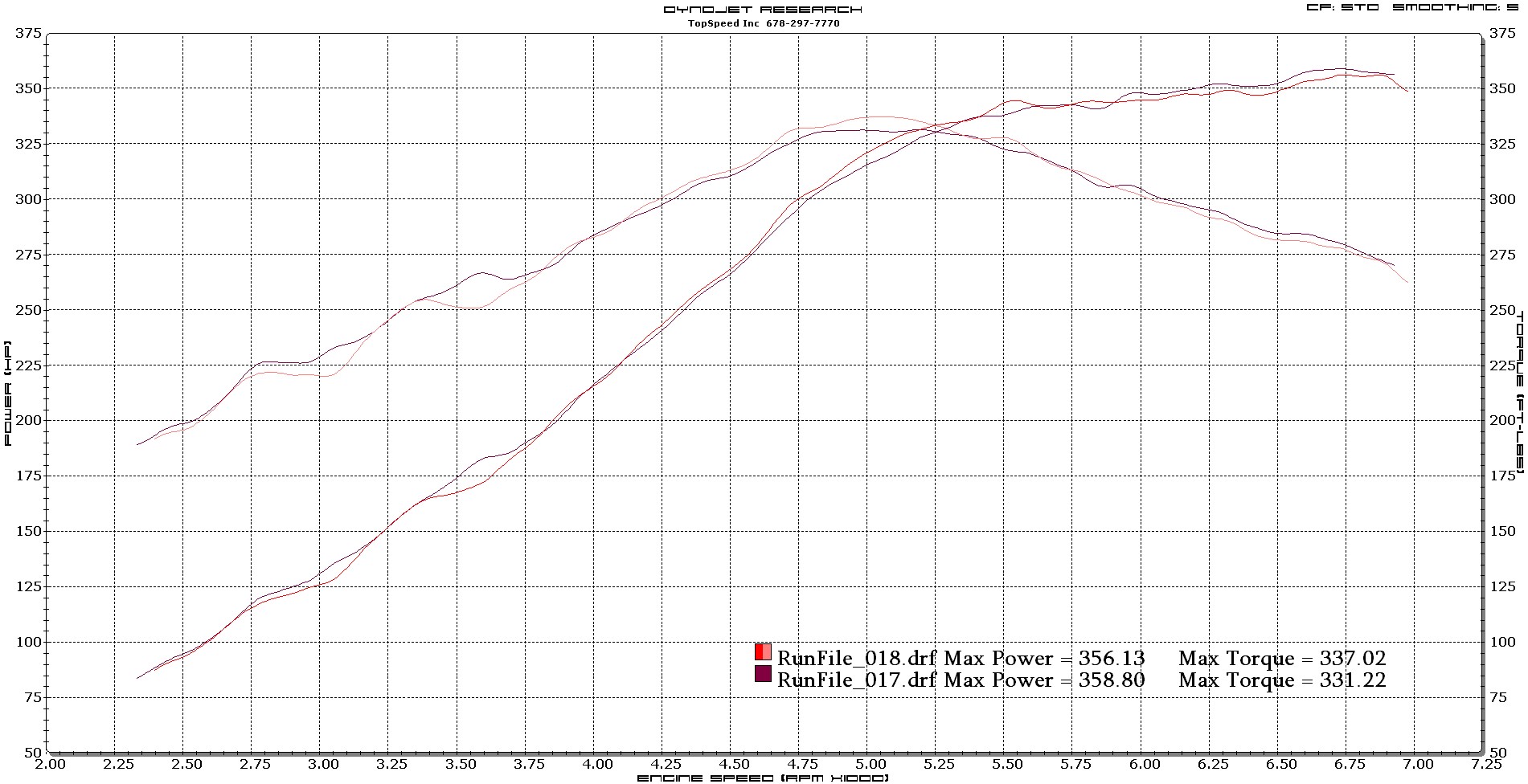

Dyno!!!
I had the car tuned at Topspeed in Alpharetta, Georgia. The guys there are great, and really took care of me. I highly recommend them!
Car is still stock block, so I opted for a super conservative tune. Should be doing a build later this year or early next year.

What's ur numbers? Can't c from cell. Any bids?

358whp 331wtq.

how much boost were you running on that dyno pull

niice!! what size turbo did you get and what psi?

Glad it all worked out Dan. Looking at the torque curve I would say your tune is very conservative, and only on spring pressure (7psi).

What gear was the dyno? how come you're not hitting peak TQ until 5K rpm?

Nice. Looks like you could still cruise in 3rd or 4th then drop the hammer when it calls for it..
I was running wastegate spring pressure, about 7 psi (0.5 bar)
I got the Precision 6262. It's at wastegate pressure (0.5 bar spring)still. Can't wait to do the engine build and turn this baby up.
Not too bad OP, I did about the same on 4.5 psi with my PowerLab 35R.
Keep in mind that your boost probably tapered off by the time you got to 6500rpm. So your boost pressure at peak HP is probably 5psi or so.
In order to keep boost even all the way to red line you need a boost controller. The exhaust pressure before the turbo will force the wastegate open more than it should, reducing your manifold pressure. It is just how things works. Ideally, the exhaust pressure before the turbo should be in the 1.5 to 1.75 times your boost pressure.

nice that it was a nice and easy install for you and that you are happy, but i say the numbers are kind of weak for 7psi on a dynojet nonetheless...what size turbo is this?
like the other guy said ive seen powerlab kits make more power or the same on much less boost and that is a kit to compare to this one far as i can tell
Read post # 17.
When I did my spring pressure run with a 7psi spring, my boost at red line was just under 5psi. You need a boost controller to keep the w/g closed/cycling in the higher RPM range.
EDIT:
Have a look at the dyno that Vas posted. 8.5 psi and 415whp 402wtq. This is why I don't like comparing numbers, the dyno is a tool.
