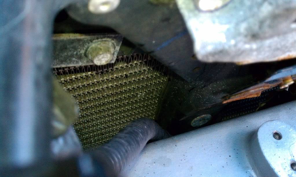

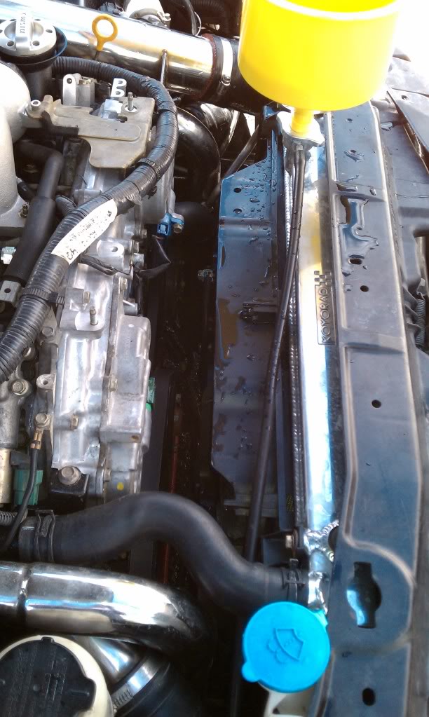

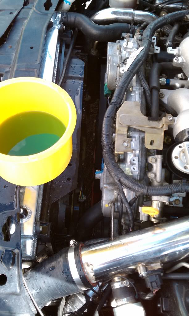

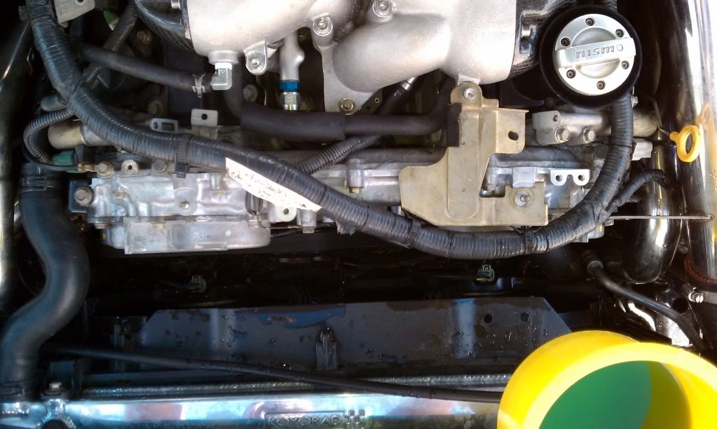

Here are the pictures I promised you Thom

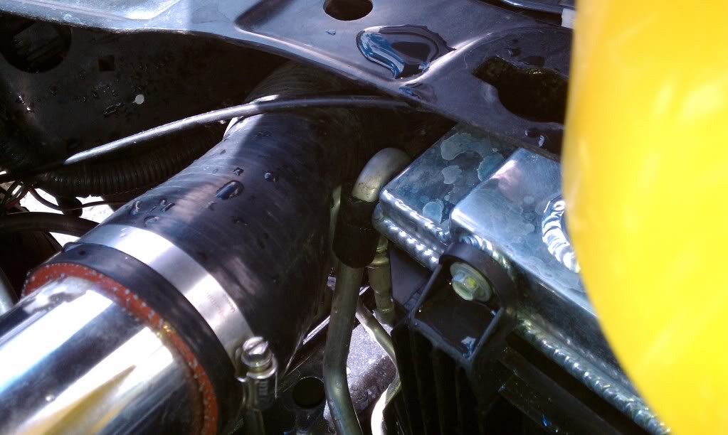

Showing how flush the ac condenser is
My only other beef is that it pinches my intake tube
