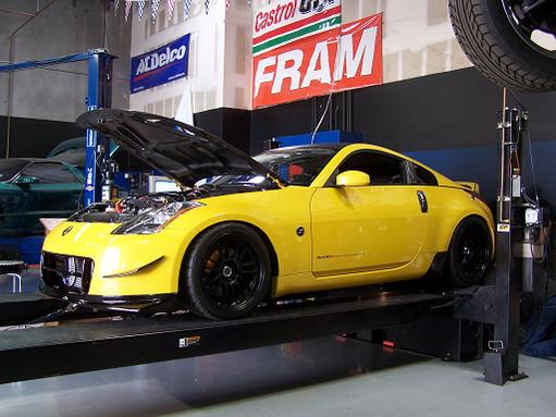

If you see this z around town you know who it is now.....
I only take it out maybe once a week if i am lucky.

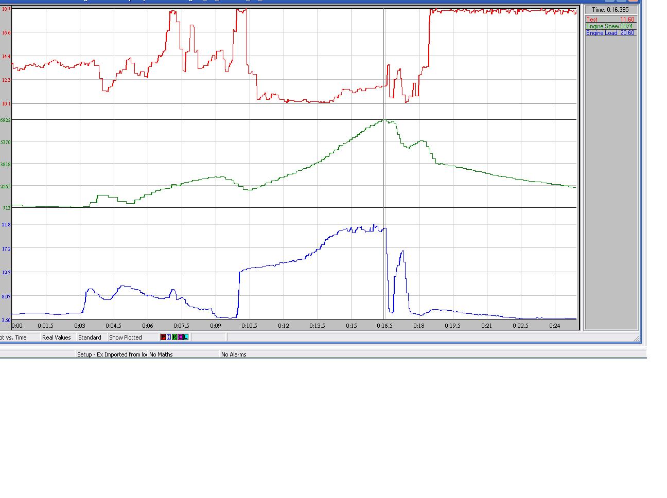

I agree, I do need a dyno and a tuner, but noone here in vegas so i gotta plan a trip soon to vegas or california i guess. I have been playing around with it though and my voltage is now down to 4.7 and is making it to redline most of the time without stuttering. my afrs also looking pretty good. 11.5 - 11.8 after it gets out of closed loop. my question is can you tune closed loop? the tuners i went to implied that you cant. however, ive been reading and have seen people modifying the short term fuel trim to get the afrs they want in closed loop. any thoughts? heres my afr on a second gear pull. i did a third gear pull as well but its on my other computer. its rich at wot up until open loop takes over at about 5300 rpm.
You can't mess with closed loop without a reflash (osiris, ect), or full standalone.
Also, open loop takes over as soon as the pedal is on the floor. It's not RPM dependent.
