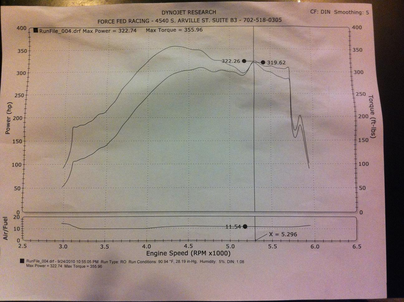

Recently got this tune out here in vegas from some guys who usually dont tune vq's but are aem certified and assured me that they could tune an aem/fic. my car runs fine and boosts well up to about 5500 to 6000 rpms before it hesitates, bogs, or misfires. Im new to FI so im not sure how to tell the difference. this tune cost me about 440 with about 6 runs on the dyno. final run they felt the tune was good. with that said, id like to hear opinions from some of the experienced guys. i have a rev up engine 06, turbonetics, 6psi. im not worry about the horsepower. i wanted conservative so with 330 hp, i wouldnt have been disappointed with the power at this point in time. i just wanted my car to run well. Im no expert so I wont make any judgments at this time. im also going to post this on the aem website and see if i can get any tuners input on this as well. Thanks

looks like the tune is probably ok, but you have something mechanically wrong. maybe spark blowout, weak coil....

That curve is horrible. The AF looks good, but you definately have some kind of ignition problem. As to the cause of that, it would take some troubleshooting to determine. Did they install the FIC as well? Perhaps a wiring issue, loose connection.

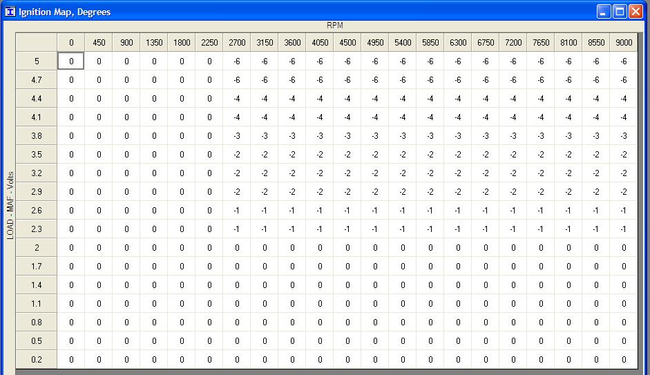

Your o2 sensors don't do anything at WOT... so that's not your problem. A/F looks fine too.
If I could call it how I see it, your timing map needs alot of work. To aggressive down low and not enough up top.
Whenever you see higher TQ than HP on a VQ (especially rev up) without breathing issues (at 6psi that turbo isn't even trying), the tune is questionable or there are serious mech. issues.

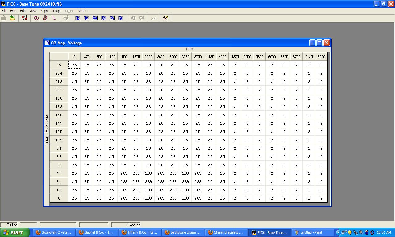

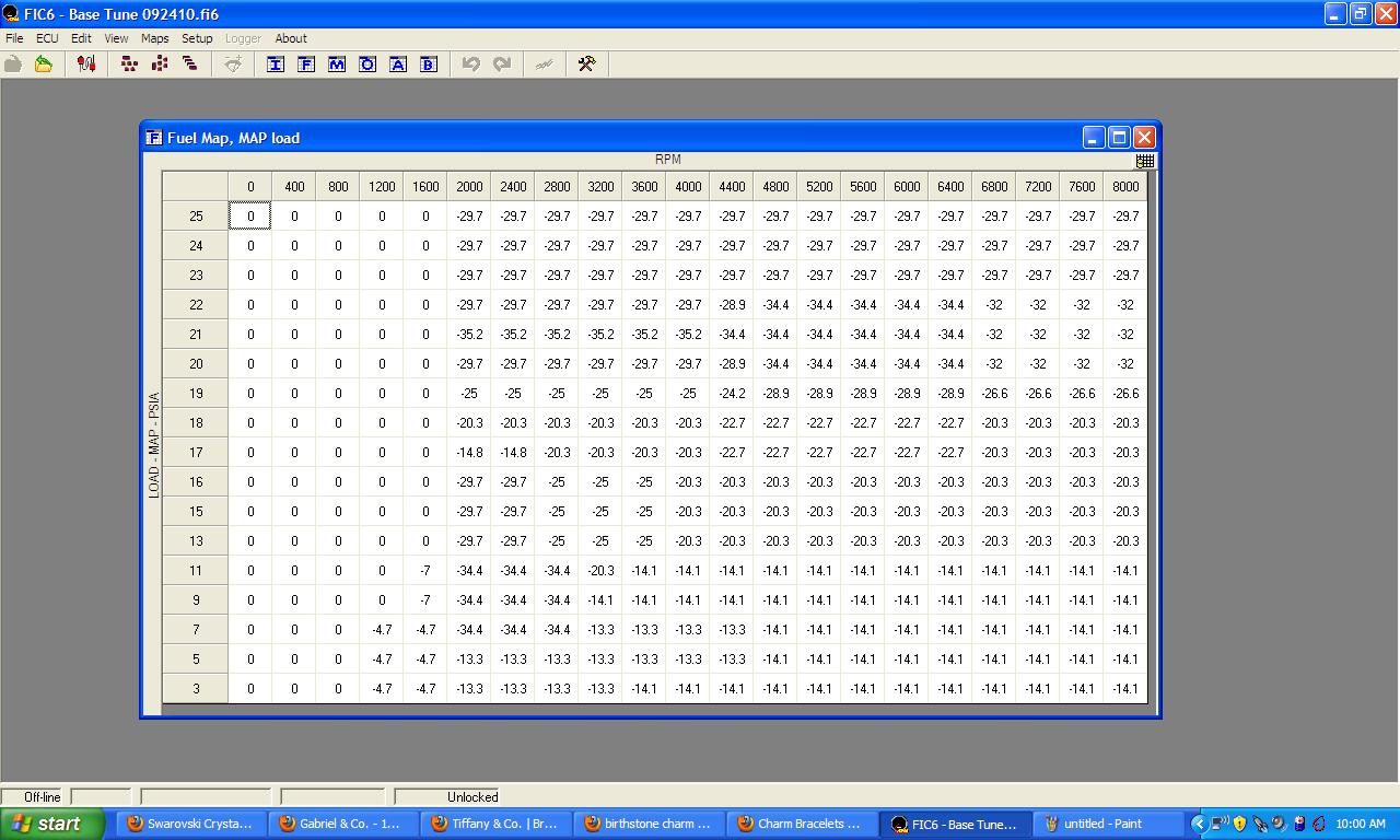

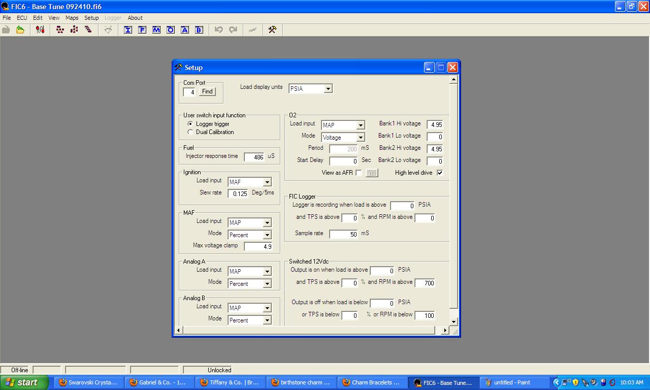

Post up the screen shots of the fuel and timing maps.
And yes, it never hurt to pull the plugs and reset those gaps.
Old Sep 30, 2010 | 09:18 AM
winNvegas's Avatar
winNvegas
Joined: Aug 2009
Posts: 42
From: las vegas
Default maps
maps and setup
Attached Thumbnails Opinions on this tune-fuel-map.jpg   Opinions on this tune-ignition.jpg   Opinions on this tune-setup.jpg   Opinions on this tune-voltage.jpg

Originally Posted by winNvegas
maps and setup
I think I found the issue. The MAF clamp needs to be set well below 5V. He has it set at 4.95V. You need to set it to 4.85V or slightly less than that. Your ECU is freaking out when it seems the overvoltage and causes the cuts and misfires...seen in many times before back in the eManage days. Keep in mind this will change the tune slightly so it needs to be verified on the dyno.
I also noticed he is using MAF as the load source for timing, but MAP as load source for fuel. Although this isnt the cause of the misfire, it's not technically the correct way to setup the tables. The engine will be happier if it's using a scaler that isn't maxed out all the time, as it will be if using MAF as the load source.
Politely mention these things to your tuner, and hopefully he'll adjust and retune for you. The misfire can be troubleshot before even going on the dyno.
