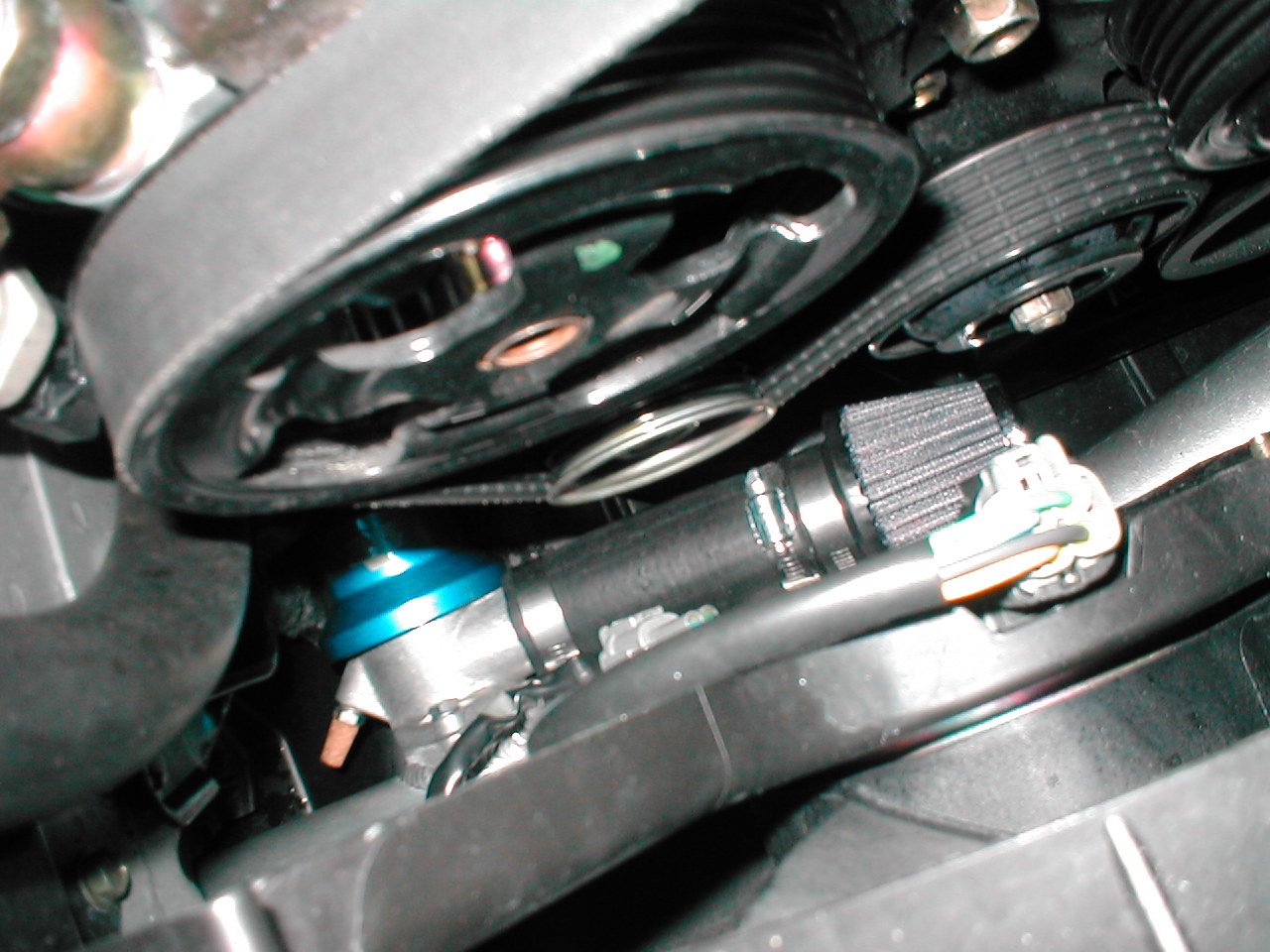

Add the Filter with a layer of 1/4" soft dense foam around the inside of the filter, works very well. It takes out 80%-90% of the BOV sound.
This was one of the very first modifications I made to my car after installing the SC and have not touched it in over 6 years.
If you like less noise, Do it........
Also with the stock Idle of about 650rpm, the back-lash in the gears in the SC makes a lot of un-wanted noise, raising the idle rpm to 800-850 will eliminate it.

also re "Add the Filter with a layer of 1/4" soft dense foam around the inside of the filter, works very well. It takes out 80%-90% of the BOV sound." i'm not sure if i understand your pic. does the foam have any neg effects? do you have any other pics of this (different angles)?

any negative effects from venting BOV back to the blower?
NO..... It is routed back to the Intake, not really to the Blower.
Sorry, no more pic's
