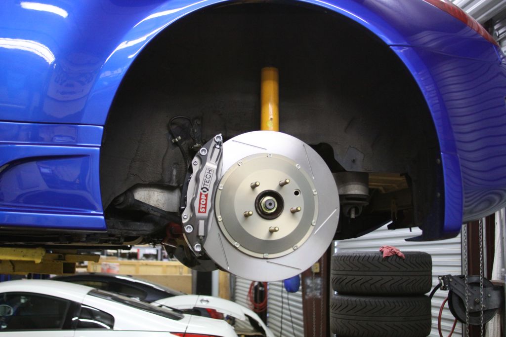

With the stock brakes on my first FI Build (ST @ 380rwhp) the brakes faded ultra-quickly whenever I really pushed the car.
I went with StopTech Trophy's. Lot's of great options out there...

They look sweet, will def be my next upgrade!
