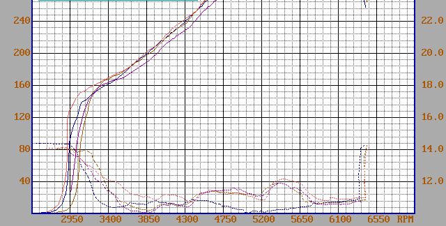

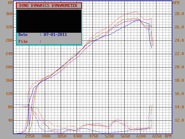

thanks all. i rev the engin to 1-1.1 k rpm and the sound goes away. it only comes on w/ the engine is warm and idle, ie non-existant in the morning when i first turn on the car
btw below are the dyno sheets, i'll do a proper crop when i go home later on today..
Attached Thumbnails Normal sound for Vortech?-1.jpg   Normal sound for Vortech?-2.jpg

bump the idle up to 950 . your rpms are to low . 10.5 is to rich . everything else your on the money .
I Hope that is Not After Tuning? AFR'S are all over the place. If you payed for that, I'd take it back and tell them to Tune It....
9.8 afr @ 3800 rpm is not Tuned, should be more like 11.8 - 12.0 @ 3800rpm
NOTHING is on the Money in your Dyno

The three non blue were after tune, but is on stock injectors /pump, ssbox. Tunner says hard to tune great due to the vortech aux pump. Thinking of just going back to ssbox base tune(blue line), the extra 40hp doesn't seem worth it
thats ********, take it somewhere else..my car was tuned perfect with the full vortech kit...on the hit id see 12.0 and slowly toward redline id be holding 11.7-11.8..It should be a steady a/f throughout..
as far as that sound, exactly what mine did..loosen the bolt for the cog belt and push down a little harder and tighten it back up...
Old Jan 8, 2011 | 01:04 PM
OldManZ350's Avatar
OldManZ350
Posts: 2,429
Likes: 230
First of all a Tuners Job is to Tune the car Properly. This guy just wants to take your money. What's his Name?
I don't think you gained 40Hp from that Tune.....
40HP is a lot and well worth it.
You don't need a Great Tune, a Good one will Do.
Based on your dyno, You have Serp Belt Silppage @ 5900rpm, you should make power to at lease 6500rpm
An Out of the Box Kit on a Non-Revup will make 320-330Whp on a DynoJet

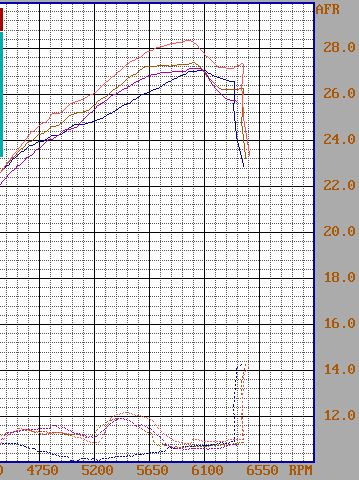

here's the dyno
the blue is the ssbox stock
the shop has been great though overall w/ the install and trying to help out. the person who did the tune has tons of experience w/ turbo's. i can ask him to just put things back to stock, or the middle tune for now (the one that maxes out to AFR 11.8) for a bit till I do the next upgrade
