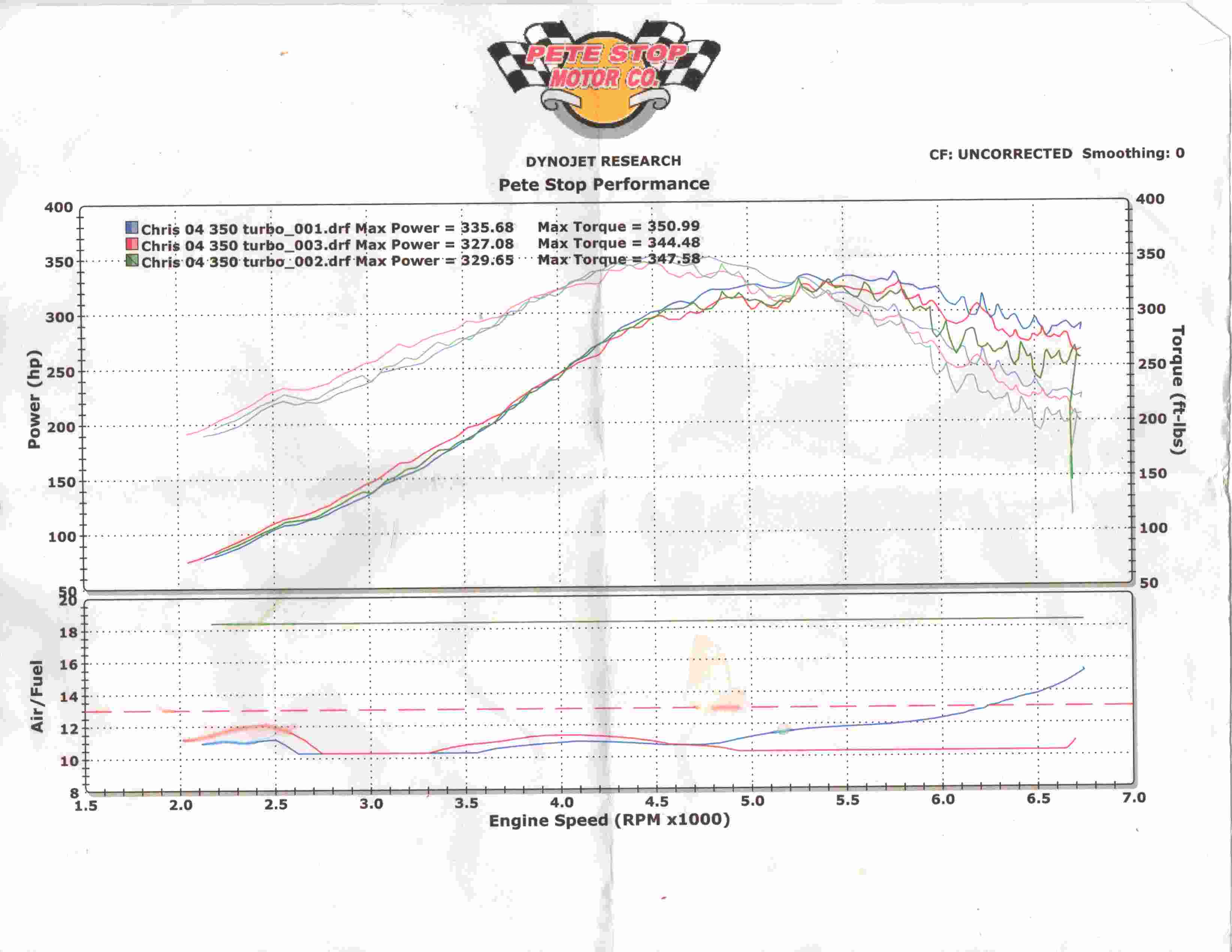

Ok, my car started going into limp mode a while back...seemed to only do it under higher boost levels like 8lbs and up. I thought it was the MAF cutting out but we put Consult on it and said it was a p1237. Thats the passanger side wideband on the exhaust manifold.
Also we dynoed my car yesterday and I was off about 80hp from my original dyno. The cars feels great but isnt making any power like it should. On the dyno there was no CEL's but on the way home under full boost it when into limp mode again. Power it made at 8lbs was 325hp/350Tq LOL!
So my question is...can a wideband sensor bad under boost cause limp mode?

I would check your compression. Also your AFR is Real Rich from the looks of your dyno. That could be a big loss of power. Also looks like a timing issue starting at 5k up. Thats just my thoughts.

Fueling problem for sure... A/F jumping between pig rich and dangerously lean... probably some timing issues and knock above 5k...stay out of boost get it to a reputable VQ tuner ASAP before you break something.

^^^ a big plus 1 as that is a horrible a/f plot.

Forgot to mention that the blue line on the dyno is where the AF thingy blew off the tailpipe on the dyno. The other rich lines are what it is tuned too. I wanted him to tune the car rich but not 10.0! Thats crazy! Im thinking that the car was tuned in the dead of summer and its winter time now with cooler air temps...but wouldnt the car still try to reach its programmed AF targets regardless?
Were doing a complete re-tune in a week or 2. I also ordered a HPX Maf and will tune for higher boost if the motor and everything checks out. Also ordering two brand new Wideband sensors for the manifolds. The stock sensors have 117,000 miles on them LOL!
So does anybody here know if a bad wideband throwing a P1273 can cause a full limp mode condition under higher boost? Whats funny is the car wont go into limp mode under lower boost.
