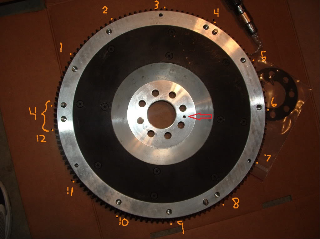

It's probably an issue with the flywheel alignment. There is a sensor that points at the outside edge of the flywheel. on the outside edge of the flywheel you will see small notches. These notches are used to report crank angle position to the ECU. The ECU uses this info to adjust the cam advance when you accelerate.
The notches on your flywheel are not aligned so the crank angle is not being picket up correctly. this is keeping your cams from advancing when accelerating.
If the mechanic run a diagnostic on your car it will probably ***** about the cam position. The root of the issue is really the flywheel alignment.
How to fix:
take a look at the pic
you see that tiny hole? that needs to be aligned with the dowel on the crank. right now that hole is not over the dowel.
Your probably wondering how the mechanic got the flywheel installed without matching the dowel to the hole. the after marked flywheels have small groves that will allow the flywheel to install flush against the crank without the dowel lining up with the small hole in the flywheel.

I marked the hole that needs to be aligned with the dowel

Is it throwing a CEL? Sounds like crank position sensor, and it uses the teeth on the flywheel to detect the crank position. It has happend to me before you have to shim the mounting tap on the sensor to get it either closer or farther from the flywheel. It has to be aligned just perfect.

Running an act prolight flywheel. I went to the shop and the mechanic called a Nissan tech and he stated the exact same thing that possibly the sensor was not aligned properly. He is removing the tranny and gonna realign everything to make sure but he's 100% sure that the sensor wasn't aligned. I can't really say for CEL because it was throwing it before. I appreciate all the info and help

It is the sensor. Exact same thing happend to me on my ACT flywheel, but I could barely drive mine and it just backfired and ran like ***. My sensor was to far away from the flywheel.
Shim a very very small portion off the tab on the sensor. Put some chalk, or similar product, on the tip of the sensor and place it back on the transmission. Slowely turn the crank pulley, with a wrench, and see if the flywheel is hitting the sensor at all. Fire the car up if the sensor is not being hit and see how it runs.
