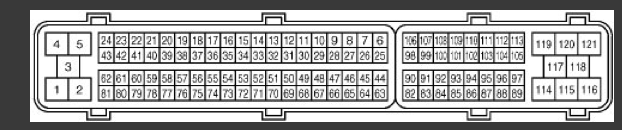

are you sure you are looking at the harness correctly. the diagram is showing the back side of the connector. so everything is mirrored/reversed when you are looking at it.
Yes, still wondering if anyone has ever heard of this. I called vortech and they didn't know
Old Jun 28, 2011 | 11:16 PM

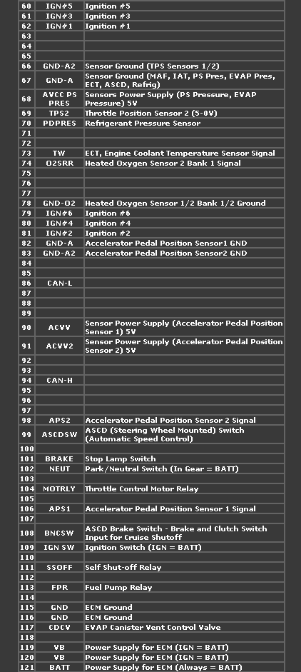

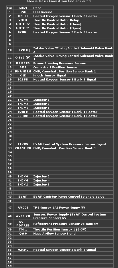

OldManZ350's Avatar
OldManZ350
Posts: 2,429
Likes: 230
That is imposable.....
I think you are just looking at it wrong, get a second pair of Eyes to look at it.....
2003 Pinout and Descriptions
Attached Thumbnails need quick reply on vortech wiring-1.png   need quick reply on vortech wiring-2.png   need quick reply on vortech wiring-3.png
