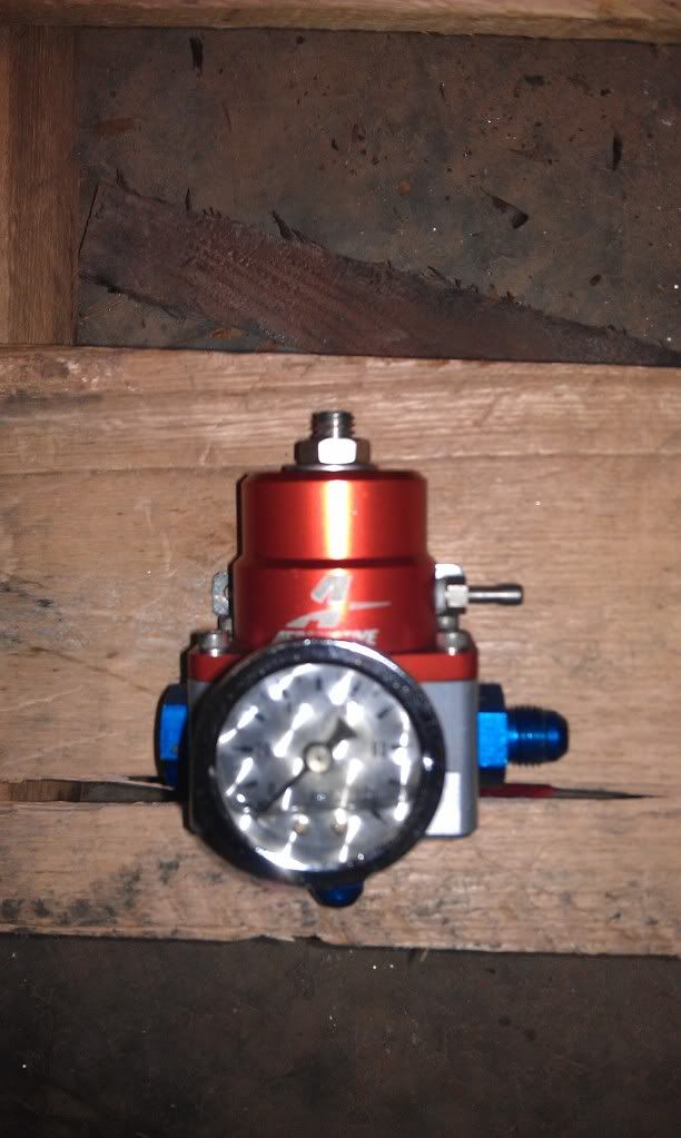

I have a new aeromotive FPR laying around i'd be willing to let you borrow if you cover shipping of course, and would even sell cheap if it fixes the problem.
i might take you up on that offer. It's the a1000-6 with the 6an ports right?
I really don't know, never really even looked at it. The guy threw it in when i bought some other stuff from him, pretty sure he said it was new, also has an extra gauge.
Heres an old pic i took when i got it, i can check the model# sometime next week if you need me to.
