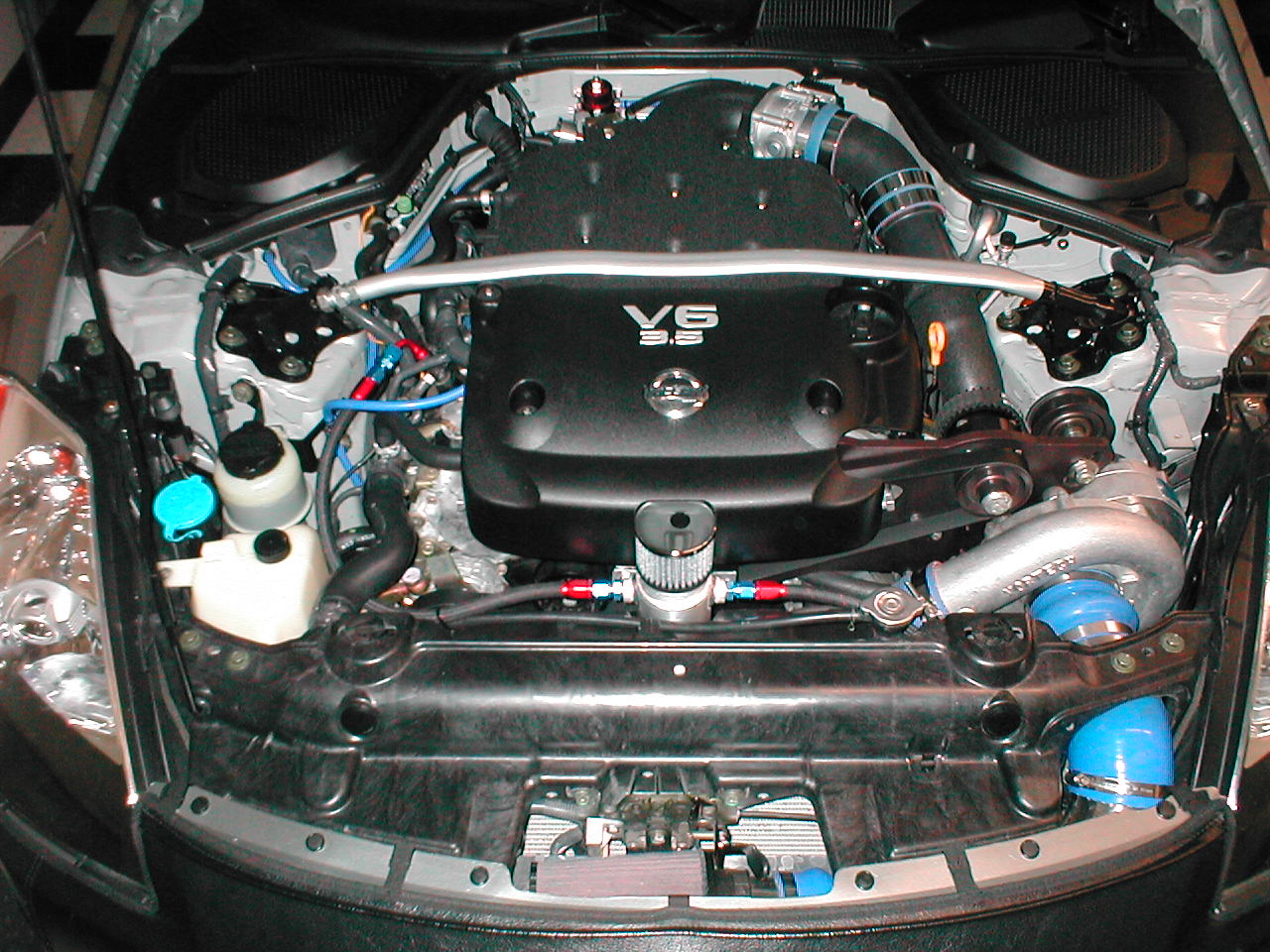

Old Dec 12, 2011 | 01:05 PM
  #60
OldManZ350's Avatar
OldManZ350
Posts: 2,429
Likes: 230
O.K. Since my last post in this thread I've Installed:
1. CJM Stage 2 Fuel System (very nice High Quality)
2. DW300 Fuel Pump
3. Breather/catch can
4. Base FP set @ 50psi
1. Instantlly Drivability Issues were gone....
2. Closed Loop easy to tune.
3. Open Loop Pain in the ***......
4. Car is making More Power
5. With a little cooler weather (70*) car is now making 16psi by 6700rpm
AFR's are Very Choppy and Wavy, will go from 12.3 - 11.0 and 11.75 - 10.80 afr in less than 250 rpm's, So that the top of the wave is way to lean and the bottom is to rich, Seams near imposable to Tune out and get flat, I'm still working on it....
Afr's were much flatter before but still had waves, any Ideas.
Also, Tires spinning after 4700 rpm in 3rd gear makes it harder to tune, the dip in boost log is from tire spin.
Log is WOT from 2900-6130rpm
please see attached Log
Attached Thumbnails Vortech Tuning, HP/TQ with 600cc Injectors-p1010015.jpg
File Type: pdf
