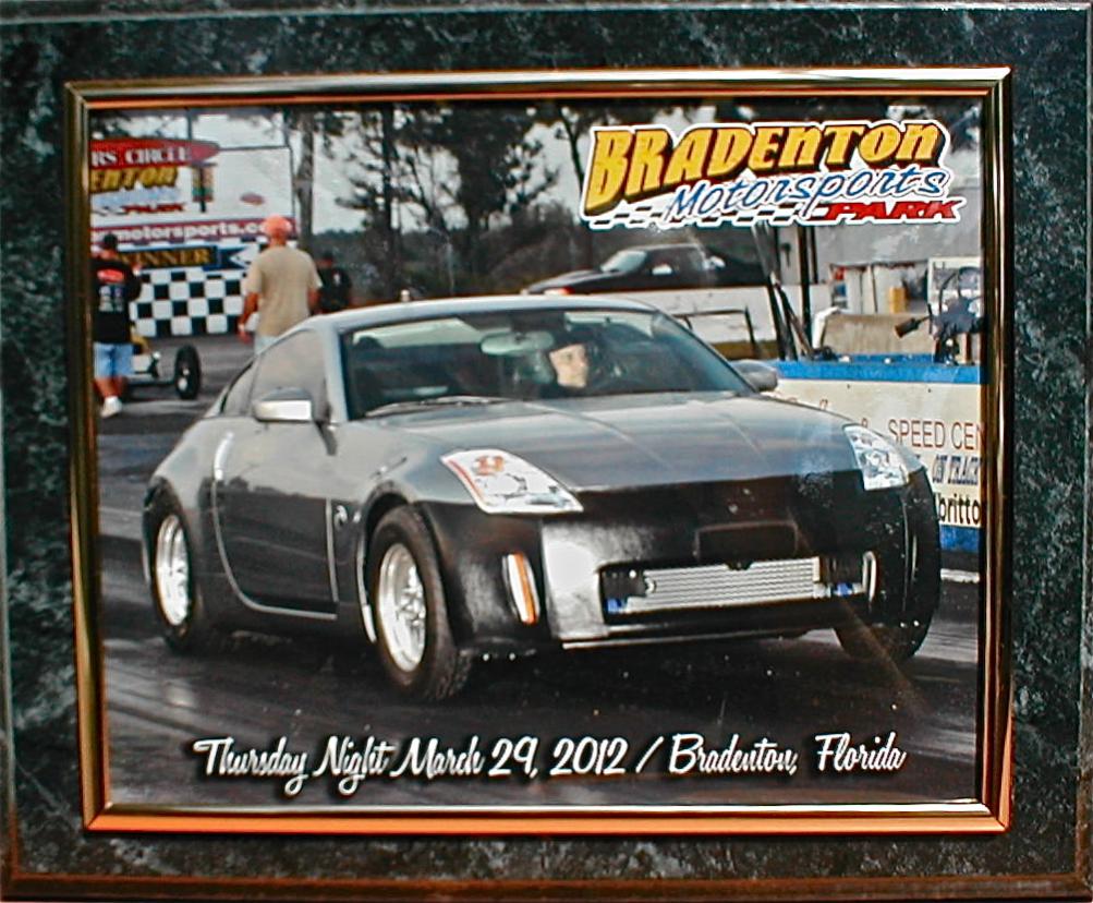

I will have to back it up with Drag Times Soon...
Best, Night of March 29, 2012
R/T........ .068
60'....... 1.704
1/8....... 7.533
MPH...... 96.65
1/4...... 11.647
MPH.... 120.48
Also got front wheels in the Air.....
Attached Thumbnails Vortech Tuning, HP/TQ with 600cc Injectors-p1010007.jpg   Vortech Tuning, HP/TQ with 600cc Injectors-p1010020.jpg

  #73
ramirj2's Avatar
ramirj2
Joined: Sep 2004
Posts: 87
From: Bayamon, Puerto Rico
Nice!
You hold the Vortech record now!
Old Mar 30, 2012 | 04:33 AM
  #74
Mr.Squeeze's Avatar
Mr.Squeeze
Posts: 249
From: Bronx N.Y/North N.J
wow talk about pushing the stock block great results
congrats on the 1/4 record
R/T........ .068
60'....... 1.704
1/8....... 7.533
MPH...... 96.65
1/4...... 11.647
MPH.... 120.48
Thanks now I have something new to work towards haha. Any vids of the run? Full interior/spare? Looks like u ran skinnies?
Curious if anyone knows what is the stock block record (f/i type aside)? Can't tell from the 1/4 times list there are no mentions if built or not..
Touring full weight with full Interior, I did have the spare out, but also had 3/4 of a tank of gas. and Front Skinnies
Per the List AJ_350z 11.036@122.24
