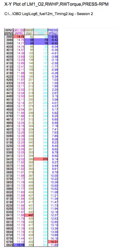

I'm in the process of Tuning My Vortech Setup once again.......
Top Log Setup
2.87, 32/28 cog, Walbro, 440cc DW's, 6/1 FMU, 4 x 12 x 24 core intercooler, headers, full exhaust, no cats, ect. ( keep in mind that in this log I rolled on the throttle, was not at WOT to about 5000rpm)
Attached Log Setup
2.87, 34/28 cog, Walbro, 600cc DW's, 3/1 FMU, 4 x 12 x 24 core intercooler, headers, full exhaust, no cats, ect.
Still a little Rich yet from about 4000rpm/5.5psi. Looks like I've gained so far a solid 20-30 WHP, and 20-30 Ft/lbs WTQ with 40 Ft/lbs WTQ in some areas. With 3/4 to 1-1/2 Pounds of Boost from 5000 up. With a much Broader HP/TQ curve. I still think their is a little More, will Lean it up a bit and see if I gain any.
Note: I would not go to a 2.87, 34/28 setup without a huge intercooler.

A Tad Leaner, 8WHp and 10Ft/lbs WTq More, Still Rich But I'm Done for the Day.....

Originally Posted by jpc350
Could you explain with what and how your tuning the car?
TIA
SplitSecond FTC1 ( fuel and Ignition )
Innovate Motorsports LM1 and LM3 (Aux Box) (WideBand, Map, Rpm, EGT's, IDC, G's, Whp, Wtq)
URD Racing BR3 Scan Tool (Fuel Trim in closed Loop)

Looks good, 4100-4400ish you could lean that out a lil. you are in vacuum and less the 3lbs of boost but your air fuels are high 11's low 12's. you trim that area in throttle response will feel alot better when entering into boost..
are you telling him to lean it all up to under 3psi? i'm not reading that comment properly i think.
what are you recommending for a/f under 3psi vince?
Old Sep 20, 2011 | 08:10 AM
Vince@R/TTuning's Avatar
Vince@R/TTuning
Vendor - Former Vendor
Joined: Jun 2009
Posts: 505
From: Lansdale, PA
^^^ not lean it out the same overall, more so have the taper a lil better....for instance at 4220 RPM he is still in vacuum and his air fuels are 11.85. lil richer then they need to be, I usually have it tapering from 13.0 under vacuum to 12.5ish around 3-4 psi and the slower tapering richer as boost builds and torque continues to climb...

i was running mid 12's all the way up til 3-4psi. then tapered to 12:1 to redline.

Vince, you are looking at my old Tune with 440cc's. I put it up for to compare. Look at the Attached File MAP 11 in Post #2. Pretty much the whole map is still too Rich in open loop. I still making changes to lean it out. what are you suggestions for AFR's.

^^^ Pretty much what strdum1 said, except maybe with the 2.87 pulley I would run it richer above 7 psi like 11.7ish. Also those "estimated" dyno numbers are prob off by about 15%...

^^^ yea def....actually if you look at the fuel curve of a lot of factory turbo cars the have really lean spool. The GTR at about 6lbs of boost air fuels were at 13:1ish from factory, and when we richened it up it greatly effected power and torque in spool.
That's just one example but a lot of cars respond the same way. Once you start doing bigger turbos you cant get away with that cause at the same boost level you might be flowing twice the air....so its all relative...
