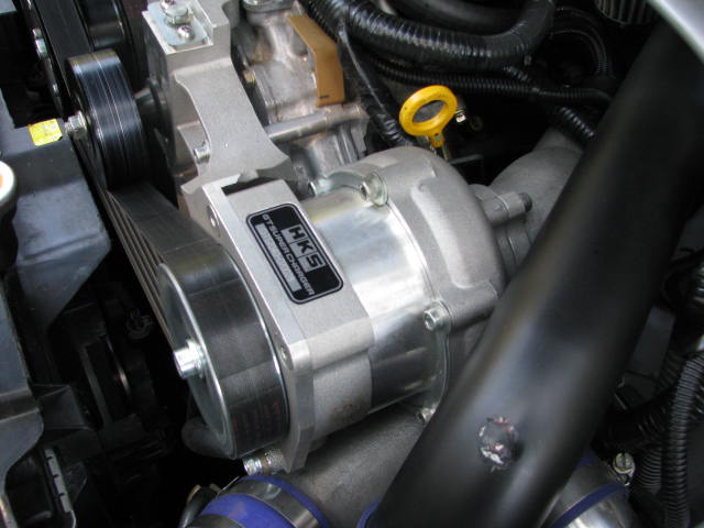

So far i'v spoken to the guys at Active Autowerke and the answer they gave you can't mix the fluids. IE Rotrex for Rotrex and HKS for HKS , so ineed work out which one i have. It's sounds like i have a Rotrex unit but i will confirm this and post again.

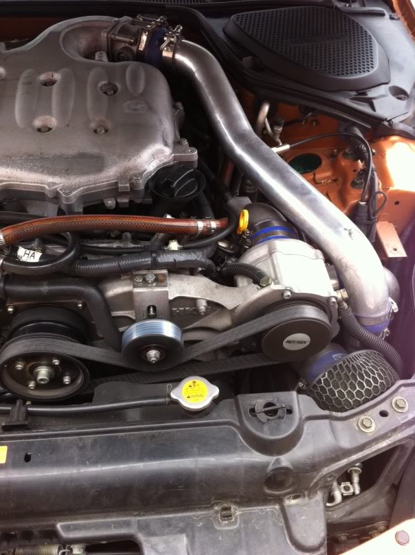

Post pics... I can tell

I'v also contacted Rotrex Australia and they are on the case as well, will post as soon as.
ai'l take some snaps tomorrow morning and post.

Here is a shot of my S/C

That's a HKS7404

This is a C30 Rotrex

That's great , thanks for that Flo-rida they are different. Looks like i'l need to go with the HKS fluid. Just for everyones reference the service needs to be done every 50000km's. I started this post way too soon..
Also after speaking to a few people it appears and i quote HKS had the license to make their own units for the JDM. they werent supposed to release to the US market. Not looking to start bung fight here, but if thats the case thats a bit naughty !!!!
Regardless, it's a very good unit!!!
